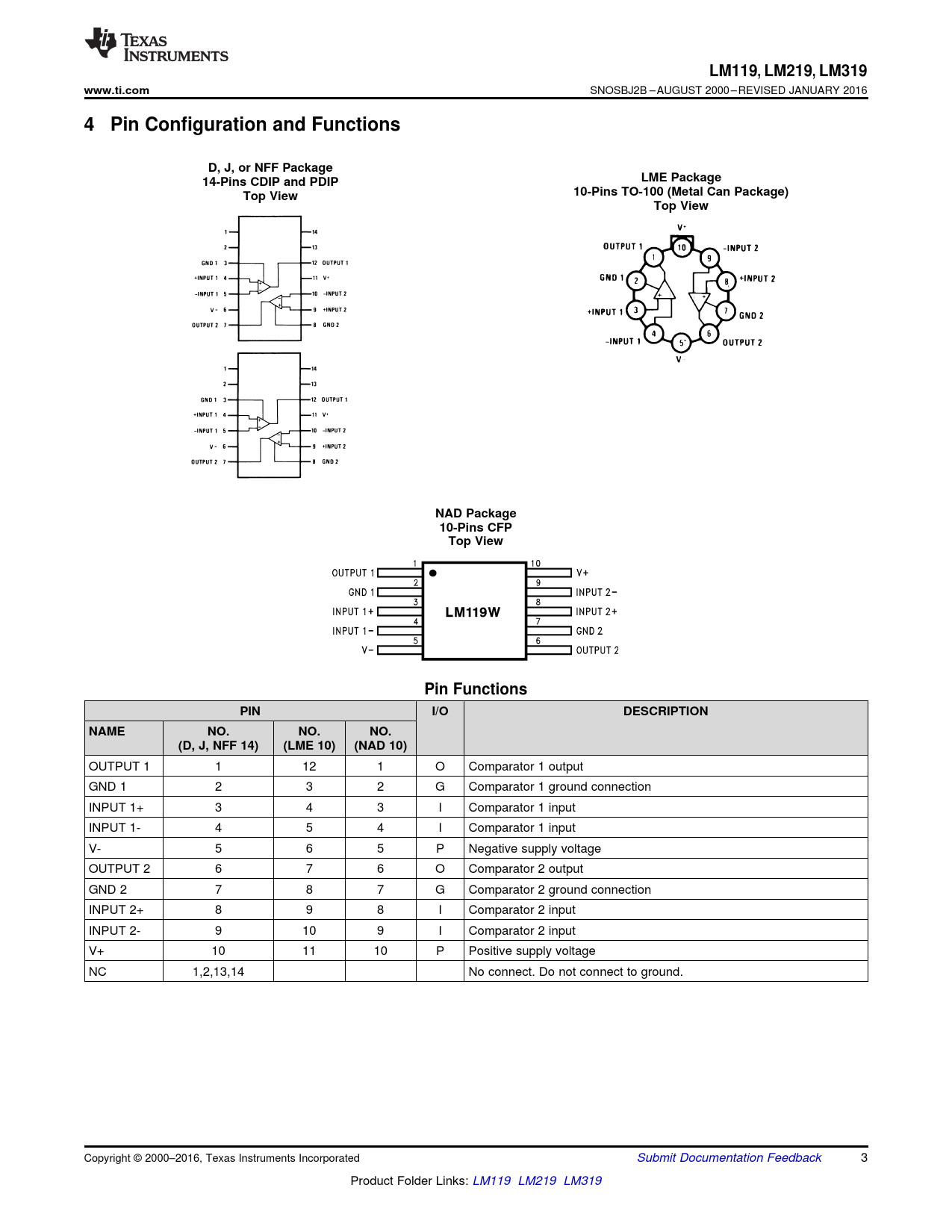

4 Pin Configuration and Functions D, J, or NFF Package 14-Pins CDIP and PDIP LME Package Top View 10-Pins TO-100 (Metal Can Package) Top View NAD Package 10-Pins CFP Top View Pin Functions PIN I/O DESCRIPTION NAME NO. NO. NO. (D, J, NFF 14) (LME 10) (NAD 10)
OUTPUT 1 1 12 1 O Comparator 1 output GND 1 2 3 2 G Comparator 1 ground connection INPUT 1+ 3 4 3 I Comparator 1 input INPUT 1- 4 5 4 I Comparator 1 input V- 5 6 5 P Negative supply voltage OUTPUT 2 6 7 6 O Comparator 2 output GND 2 7 8 7 G Comparator 2 ground connection INPUT 2+ 8 9 8 I Comparator 2 input INPUT 2- 9 10 9 I Comparator 2 input V+ 10 11 10 P Positive supply voltage NC 1,2,13,14 No connect. Do not connect to ground. Copyright © 2000–2016, Texas Instruments Incorporated Submit Documentation Feedback 3 Product Folder Links: LM119 LM219 LM319 Document Outline 1 Features 2 Description Table of Contents 3 Revision History 4 Pin Configuration and Functions 5 Specifications 5.1 Absolute Maximum Ratings 5.2 ESD Ratings 5.3 Thermal Information 5.4 Electrical Characteristics LM119, LM219 5.5 Electrical Characteristics LM319, LM319A 5.6 Typical Characteristics 5.6.1 Typical Characteristics – LM119, LM119A, LM219 5.6.2 Typical Characteristics – LM319, LM319A 6 Detailed Description 6.1 Functional Block Diagram 7 Application and Implementation 7.1 Typical Applications 7.1.1 Relay Driver 7.1.2 Window Detector 8 Device and Documentation Support 8.1 Related Links 8.2 Community Resources 8.3 Trademarks 8.4 Electrostatic Discharge Caution 8.5 Glossary 9 Mechanical, Packaging, and Orderable Information
