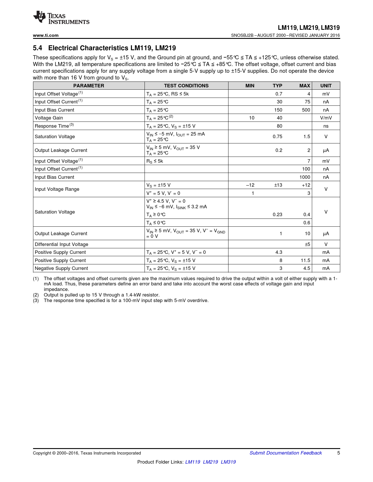

LM119,. LM219. , LM319. www.ti.com. 5.4 Electrical Characteristics LM119, LM219. PARAMETER. TEST CONDITIONS. MIN. TYP. MAX. UNIT
LM119, LM219 , LM319 www.ti.com 5.4 Electrical Characteristics LM119, LM219 PARAMETER TEST CONDITIONS MIN TYP MAX UNIT
SNOSBJ2B – AUGUST 2000 – REVISED JANUARY 2016
These specifications apply for VS = ±15 V, and the Ground pin at ground, and −55°C ≤ TA ≤ +125°C, unless otherwise stated. With the LM219, all temperature specifications are limited to −25°C ≤ TA ≤ +85°C. The offset voltage, offset current and bias current specifications apply for any supply voltage from a single 5-V supply up to ±15-V supplies. Do not operate the device with more than 16 V from ground to VS.
Input Offset Voltage(1) TA = 25°C, RS ≤ 5k 0.7 4 mV Input Offset Current (1) TA = 25°C 30 75 nA Input Bias Current TA = 25°C 150 500 nA Voltage Gain TA = 25°C(2) 10 40 V/mV Response Time(3) TA = 25°C, VS = ±15 V 80 ns V Saturation Voltage IN ≤ −5 mV, IOUT = 25 mA 0.75 1.5 V TA = 25°C V Output Leakage Current IN ≥ 5 mV, VOUT = 35 V 0.2 2 µA TA = 25°C Input Offset Voltage(1) RS ≤ 5k 7 mV Input Offset Current (1) 100 nA Input Bias Current 1000 nA VS = ±15 V –12 ±13 +12 Input Voltage Range V V+ = 5 V, V- = 0 1 3 V+ ≥ 4.5 V, V− = 0 VIN ≤ −6 mV, ISINK ≤ 3.2 mA Saturation Voltage V TA ≥ 0°C 0.23 0.4 TA ≤ 0°C 0.6 V Output Leakage Current IN ≥ 5 mV, VOUT = 35 V, V− = VGND 1 10 µA = 0 V Differential Input Voltage ±5 V Positive Supply Current TA = 25°C, V+ = 5 V, V− = 0 4.3 mA Positive Supply Current TA = 25°C, VS = ±15 V 8 11.5 mA Negative Supply Current TA = 25°C, VS = ±15 V 3 4.5 mA (1) The offset voltages and offset currents given are the maximum values required to drive the output within a volt of either supply with a 1- mA load. Thus, these parameters define an error band and take into account the worst case effects of voltage gain and input impedance. (2) Output is pulled up to 15 V through a 1.4-kW resistor. (3) The response time specified is for a 100-mV input step with 5-mV overdrive. Copyright © 2000–2016, Texas Instruments Incorporated Submit Documentation Feedback 5 Product Folder Links: LM119 LM219 LM319 Document Outline 1 Features 2 Description Table of Contents 3 Revision History 4 Pin Configuration and Functions 5 Specifications 5.1 Absolute Maximum Ratings 5.2 ESD Ratings 5.3 Thermal Information 5.4 Electrical Characteristics LM119, LM219 5.5 Electrical Characteristics LM319, LM319A 5.6 Typical Characteristics 5.6.1 Typical Characteristics – LM119, LM119A, LM219 5.6.2 Typical Characteristics – LM319, LM319A 6 Detailed Description 6.1 Functional Block Diagram 7 Application and Implementation 7.1 Typical Applications 7.1.1 Relay Driver 7.1.2 Window Detector 8 Device and Documentation Support 8.1 Related Links 8.2 Community Resources 8.3 Trademarks 8.4 Electrostatic Discharge Caution 8.5 Glossary 9 Mechanical, Packaging, and Orderable Information
