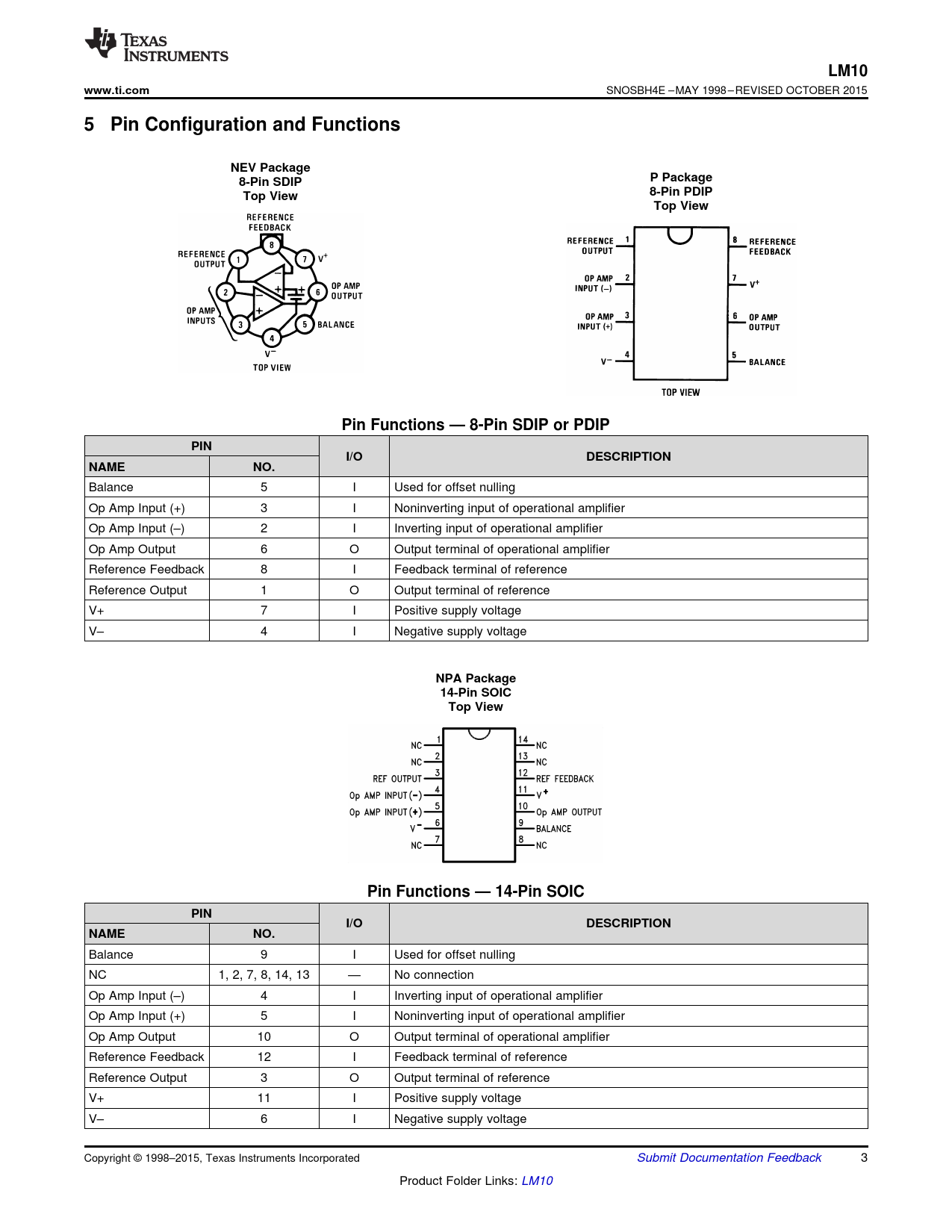

LM10. www.ti.com. 5 Pin Configuration and Functions. NEV Package. P Package. 8-Pin SDIP. 8-Pin PDIP. Top View
LM10 www.ti.com
SNOSBH4E – MAY 1998 – REVISED OCTOBER 2015
5 Pin Configuration and Functions NEV Package P Package 8-Pin SDIP 8-Pin PDIP Top View Top View Pin Functions — 8-Pin SDIP or PDIP PIN I/O DESCRIPTION NAME NO.
Balance 5 I Used for offset nulling Op Amp Input (+) 3 I Noninverting input of operational amplifier Op Amp Input (–) 2 I Inverting input of operational amplifier Op Amp Output 6 O Output terminal of operational amplifier Reference Feedback 8 I Feedback terminal of reference Reference Output 1 O Output terminal of reference V+ 7 I Positive supply voltage V– 4 I Negative supply voltage
NPA Package 14-Pin SOIC Top View Pin Functions — 14-Pin SOIC PIN I/O DESCRIPTION NAME NO.
Balance 9 I Used for offset nulling NC 1, 2, 7, 8, 14, 13 — No connection Op Amp Input (–) 4 I Inverting input of operational amplifier Op Amp Input (+) 5 I Noninverting input of operational amplifier Op Amp Output 10 O Output terminal of operational amplifier Reference Feedback 12 I Feedback terminal of reference Reference Output 3 O Output terminal of reference V+ 11 I Positive supply voltage V– 6 I Negative supply voltage Copyright © 1998–2015, Texas Instruments Incorporated Submit Documentation Feedback 3 Product Folder Links: LM10 Document Outline 1 Features 2 Applications 3 Description Table of Contents 4 Revision History 5 Pin Configuration and Functions 6 Specifications 6.1 Absolute Maximum Ratings 6.2 Recommended Operating Conditions 6.3 Thermal Information 6.4 Electrical Characteristics LM10/LM10B 6.5 Electrical Characteristics, LM10C 6.6 Electrical Characteristics, LM10BL 6.7 Electrical Characteristics, LM10CL 6.8 Typical Characteristics 6.8.1 Typical Characteristics (Op Amp) 6.8.2 Typical Characteristics (Reference) 7 Detailed Description 7.1 Overview 7.2 Functional Block Diagram 7.3 Feature Description 7.3.1 Operating Characteristics 7.3.2 Common-Mode Voltage Range 7.3.3 Operational Amplifier 7.3.4 Voltage Reference 7.4 Device Functional Modes 7.4.1 Floating Mode 7.4.2 Linear Operation 8 Application and Implementation 8.1 Application Information 8.2 Typical Application 8.2.1 Design Requirements 8.2.2 Detailed Design Procedure 8.2.3 Application Curve 8.3 System Examples 8.3.1 Operational Amplifier Offset Adjustment 8.3.2 Positive Regulators 8.3.3 Reference and Internal Regulator 9 Power Supply Recommendations 10 Layout 10.1 Layout Guidelines 10.2 Layout Example 11 Device and Documentation Support 11.1 Device Support 11.1.1 Device Nomenclature 11.1.1.1 Definition of Terms 11.2 Documentation Support 11.2.1 Related Documentation 11.3 Community Resources 11.4 Trademarks 11.5 Electrostatic Discharge Caution 11.6 Glossary 12 Mechanical, Packaging, and Orderable Information
