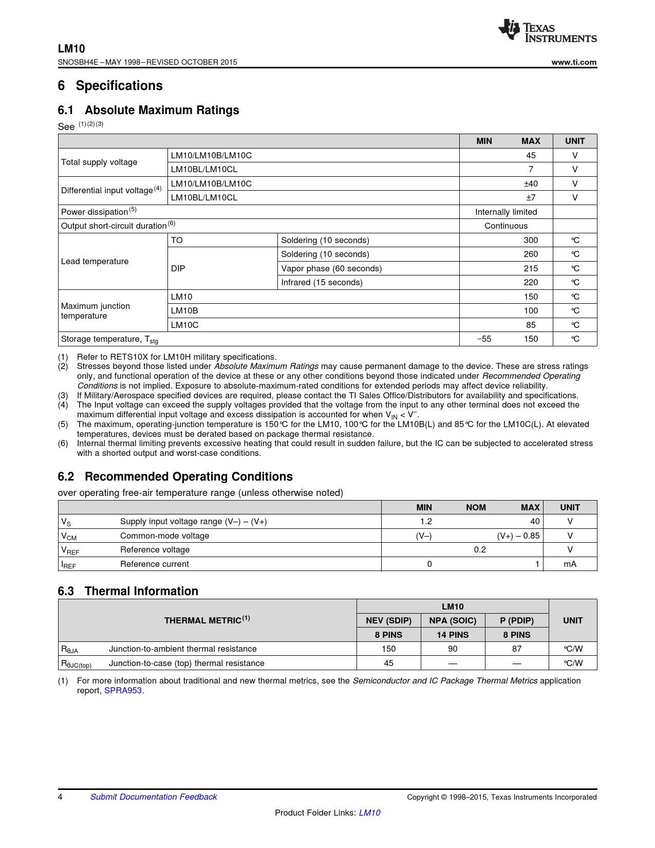

LM10. www.ti.com. 6 Specifications. 6.1 Absolute Maximum Ratings. MIN. MAX. UNIT. 6.2 Recommended Operating Conditions. NOM
LM10
SNOSBH4E – MAY 1998 – REVISED OCTOBER 2015
www.ti.com 6 Specifications 6.1 Absolute Maximum Ratings
See (1)(2)(3)
MIN MAX UNIT
LM10/LM10B/LM10C 45 V Total supply voltage LM10BL/LM10CL 7 V LM10/LM10B/LM10C ±40 V Differential input voltage(4) LM10BL/LM10CL ±7 V Power dissipation(5) Internally limited Output short-circuit duration(6) Continuous TO Soldering (10 seconds) 300 °C Soldering (10 seconds) 260 °C Lead temperature DIP Vapor phase (60 seconds) 215 °C Infrared (15 seconds) 220 °C LM10 150 °C Maximum junction LM10B 100 °C temperature LM10C 85 °C Storage temperature, Tstg −55 150 °C (1) Refer to RETS10X for LM10H military specifications. (2) Stresses beyond those listed under Absolute Maximum Ratings may cause permanent damage to the device. These are stress ratings only, and functional operation of the device at these or any other conditions beyond those indicated under Recommended Operating Conditions is not implied. Exposure to absolute-maximum-rated conditions for extended periods may affect device reliability. (3) If Military/Aerospace specified devices are required, please contact the TI Sales Office/Distributors for availability and specifications. (4) The Input voltage can exceed the supply voltages provided that the voltage from the input to any other terminal does not exceed the maximum differential input voltage and excess dissipation is accounted for when VIN < V−. (5) The maximum, operating-junction temperature is 150°C for the LM10, 100°C for the LM10B(L) and 85°C for the LM10C(L). At elevated temperatures, devices must be derated based on package thermal resistance. (6) Internal thermal limiting prevents excessive heating that could result in sudden failure, but the IC can be subjected to accelerated stress with a shorted output and worst-case conditions.
over operating free-air temperature range (unless otherwise noted)
MIN NOM MAX UNIT
VS Supply input voltage range (V–) – (V+) 1.2 40 V VCM Common-mode voltage (V–) (V+) – 0.85 V VREF Reference voltage 0.2 V IREF Reference current 0 1 mA
6.3 Thermal Information LM10 THERMAL METRIC(1) NEV (SDIP) NPA (SOIC) P (PDIP) UNIT 8 PINS 14 PINS 8 PINS
RθJA Junction-to-ambient thermal resistance 150 90 87 °C/W RθJC(top) Junction-to-case (top) thermal resistance 45 — — °C/W (1) For more information about traditional and new thermal metrics, see the Semiconductor and IC Package Thermal Metrics application report, SPRA953. 4 Submit Documentation Feedback Copyright © 1998–2015, Texas Instruments Incorporated Product Folder Links: LM10 Document Outline 1 Features 2 Applications 3 Description Table of Contents 4 Revision History 5 Pin Configuration and Functions 6 Specifications 6.1 Absolute Maximum Ratings 6.2 Recommended Operating Conditions 6.3 Thermal Information 6.4 Electrical Characteristics LM10/LM10B 6.5 Electrical Characteristics, LM10C 6.6 Electrical Characteristics, LM10BL 6.7 Electrical Characteristics, LM10CL 6.8 Typical Characteristics 6.8.1 Typical Characteristics (Op Amp) 6.8.2 Typical Characteristics (Reference) 7 Detailed Description 7.1 Overview 7.2 Functional Block Diagram 7.3 Feature Description 7.3.1 Operating Characteristics 7.3.2 Common-Mode Voltage Range 7.3.3 Operational Amplifier 7.3.4 Voltage Reference 7.4 Device Functional Modes 7.4.1 Floating Mode 7.4.2 Linear Operation 8 Application and Implementation 8.1 Application Information 8.2 Typical Application 8.2.1 Design Requirements 8.2.2 Detailed Design Procedure 8.2.3 Application Curve 8.3 System Examples 8.3.1 Operational Amplifier Offset Adjustment 8.3.2 Positive Regulators 8.3.3 Reference and Internal Regulator 9 Power Supply Recommendations 10 Layout 10.1 Layout Guidelines 10.2 Layout Example 11 Device and Documentation Support 11.1 Device Support 11.1.1 Device Nomenclature 11.1.1.1 Definition of Terms 11.2 Documentation Support 11.2.1 Related Documentation 11.3 Community Resources 11.4 Trademarks 11.5 Electrostatic Discharge Caution 11.6 Glossary 12 Mechanical, Packaging, and Orderable Information
