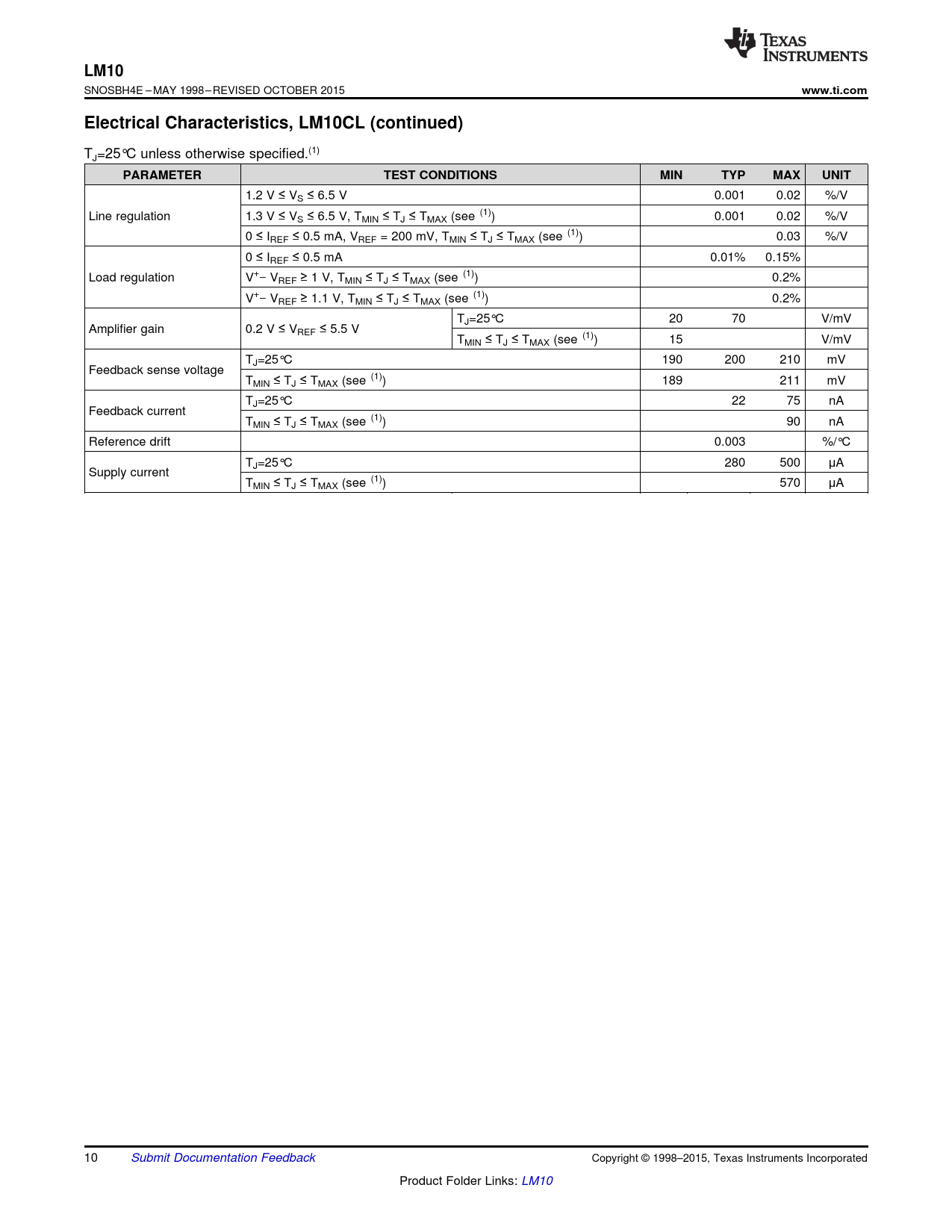

LM10
SNOSBH4E – MAY 1998 – REVISED OCTOBER 2015
www.ti.com Electrical Characteristics, LM10CL (continued)
TJ=25°C unless otherwise specified.(1)
PARAMETER TEST CONDITIONS MIN TYP MAX UNIT
1.2 V ≤ VS ≤ 6.5 V 0.001 0.02 %/V Line regulation 1.3 V ≤ VS ≤ 6.5 V, TMIN ≤ TJ ≤ TMAX (see (1)) 0.001 0.02 %/V 0 ≤ IREF ≤ 0.5 mA, VREF = 200 mV, TMIN ≤ TJ ≤ TMAX (see (1)) 0.03 %/V 0 ≤ IREF ≤ 0.5 mA 0.01% 0.15% Load regulation V+− VREF ≥ 1 V, TMIN ≤ TJ ≤ TMAX (see (1)) 0.2% V+− VREF ≥ 1.1 V, TMIN ≤ TJ ≤ TMAX (see (1)) 0.2% TJ=25°C 20 70 V/mV Amplifier gain 0.2 V ≤ VREF ≤ 5.5 V TMIN ≤ TJ ≤ TMAX (see (1)) 15 V/mV TJ=25°C 190 200 210 mV Feedback sense voltage TMIN ≤ TJ ≤ TMAX (see (1)) 189 211 mV TJ=25°C 22 75 nA Feedback current TMIN ≤ TJ ≤ TMAX (see (1)) 90 nA Reference drift 0.003 %/°C TJ=25°C 280 500 μA Supply current TMIN ≤ TJ ≤ TMAX (see (1)) 570 μA 10 Submit Documentation Feedback Copyright © 1998–2015, Texas Instruments Incorporated Product Folder Links: LM10 Document Outline 1 Features 2 Applications 3 Description Table of Contents 4 Revision History 5 Pin Configuration and Functions 6 Specifications 6.1 Absolute Maximum Ratings 6.2 Recommended Operating Conditions 6.3 Thermal Information 6.4 Electrical Characteristics LM10/LM10B 6.5 Electrical Characteristics, LM10C 6.6 Electrical Characteristics, LM10BL 6.7 Electrical Characteristics, LM10CL 6.8 Typical Characteristics 6.8.1 Typical Characteristics (Op Amp) 6.8.2 Typical Characteristics (Reference) 7 Detailed Description 7.1 Overview 7.2 Functional Block Diagram 7.3 Feature Description 7.3.1 Operating Characteristics 7.3.2 Common-Mode Voltage Range 7.3.3 Operational Amplifier 7.3.4 Voltage Reference 7.4 Device Functional Modes 7.4.1 Floating Mode 7.4.2 Linear Operation 8 Application and Implementation 8.1 Application Information 8.2 Typical Application 8.2.1 Design Requirements 8.2.2 Detailed Design Procedure 8.2.3 Application Curve 8.3 System Examples 8.3.1 Operational Amplifier Offset Adjustment 8.3.2 Positive Regulators 8.3.3 Reference and Internal Regulator 9 Power Supply Recommendations 10 Layout 10.1 Layout Guidelines 10.2 Layout Example 11 Device and Documentation Support 11.1 Device Support 11.1.1 Device Nomenclature 11.1.1.1 Definition of Terms 11.2 Documentation Support 11.2.1 Related Documentation 11.3 Community Resources 11.4 Trademarks 11.5 Electrostatic Discharge Caution 11.6 Glossary 12 Mechanical, Packaging, and Orderable Information
