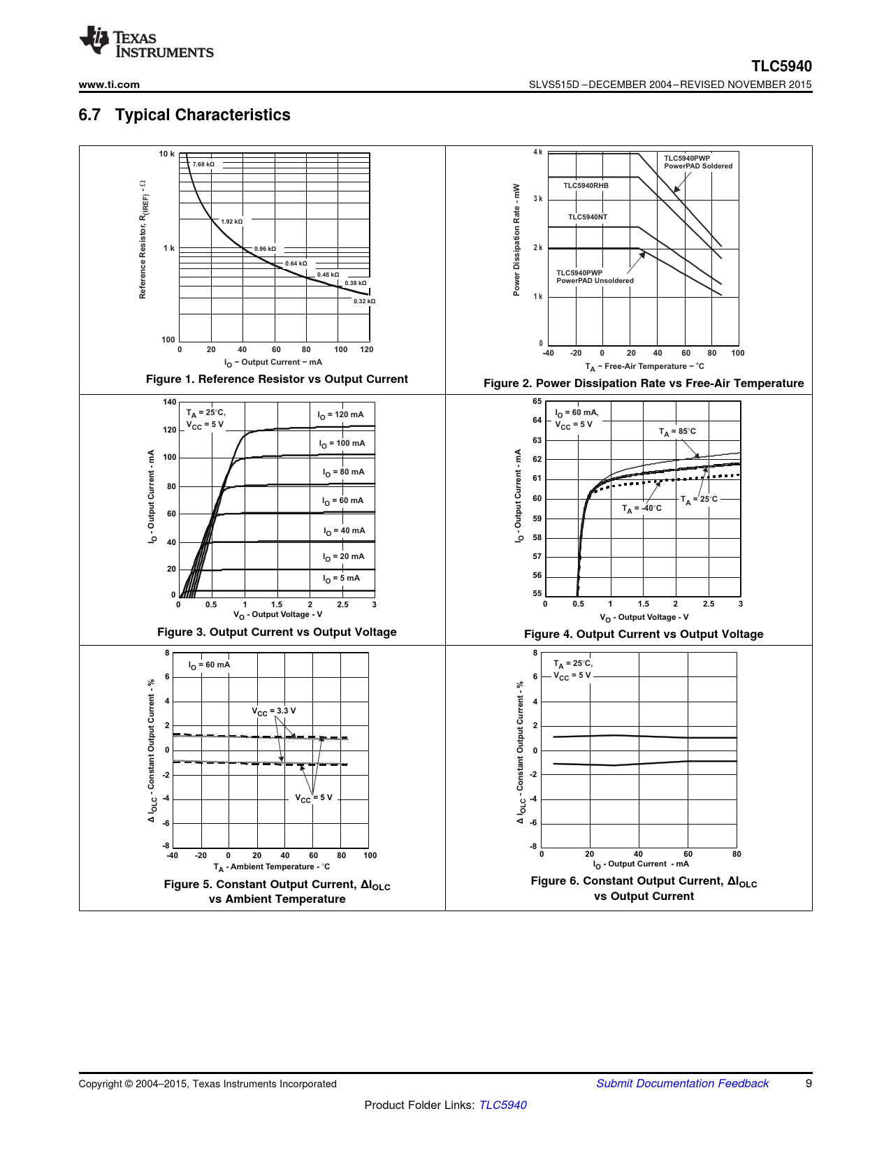

TLC5940. www.ti.com. 6.7 Typical Characteristics. 4 k. 10 k. TLC5940PWP. 7.68 kΩ. PowerPAD Soldered. TLC5940RHB. 3 k. EF) R (I. TLC5940NT
TLC5940 www.ti.com 6.7 Typical Characteristics 4 k 10 k TLC5940PWP 7.68 kΩ PowerPAD Soldered TLC5940RHB 3 k EF) R (I TLC5940NT
TLC5940 www.ti.com
SLVS515D – DECEMBER 2004 – REVISED NOVEMBER 2015
W
TLC5940RHB - 3 k EF) R (I TLC5940NT ,R 1.92 kΩ 1 k 0.96 kΩ 2 k 0.64 kΩ TLC5940PWP 0.48 kΩ PowerPAD Unsoldered 0.38 kΩ PowerDissipationRate-mW ReferenceResistor 1 k 0.32 kΩ 100 0 0 20 40 60 80 100 120 -40 -20 0 20 40 60 80 100 I − Output Current − mA O T − Free-Air Temperature − C o A Figure 1. Reference Resistor vs Output Current Figure 2. Power Dissipation Rate vs Free-Air Temperature 140 65 T = 25
C, I = 60 mA, A I = 120 mA O O 64 V = 5 V V = 5 V CC CC 120 T = 85 C A
63 I = 100 mA O 100 62 I = 80 mA O 61 80 60 I = 60 mA T = 25 C O A
T = -40 C A
60 59 -OutputCurrent-mA I = 40 mA -OutputCurrent-mA O O O 58 I I 40 I = 20 mA 57 O 20 56 I = 5 mA O 55 0 0 0.5 1 1.5 2 2.5 3 0 0.5 1 1.5 2 2.5 3 V - Output Voltage - V O V - Output Voltage - V O Figure 3. Output Current vs Output Voltage Figure 4. Output Current vs Output Voltage 8 8 I = 60 mA T = 25
C, O A 6 6 V = 5 V CC 4 4 V = 3.3 V CC 2 2 0 0 -2 -2 -ConstantOutputCurrent-% -ConstantOutputCurrent-% -4 V = 5 V -4 LC CC LC I O I O Δ -6 Δ -6 -8 -8 -40 -20 0 20 40 60 80 100 0 20 40 60 80 T - Ambient Temperature - C I - Output Current - mA A
O Figure 6. Constant Output Current, ΔI Figure 5. Constant Output Current, ΔI OLC OLC vs Output Current vs Ambient Temperature
