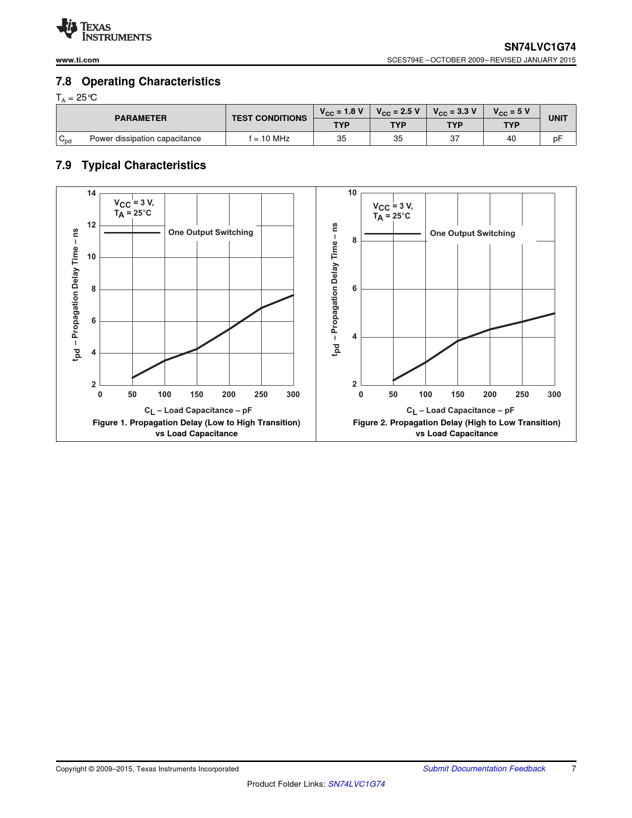

7.8 Operating Characteristics
TA = 25°C
VCC = 1.8 V VCC = 2.5 V VCC = 3.3 V VCC = 5 V PARAMETER TEST CONDITIONS UNIT TYP TYP TYP TYP
Cpd Power dissipation capacitance f = 10 MHz 35 35 37 40 pF
7.9 Typical Characteristics 14 10 VCC = 3 V, VCC = 3 V, TA = 25
C TA = 25
C 12 One Output Switching ns ns One Output Switching 8 ime ime 10 T T Delay Delay 8 6 6 Propagation Propagation 4 4 t pd t pd 2 2 0 50 100 150 200 250 300 0 50 100 150 200 250 300 CL – Load Capacitance – pF CL – Load Capacitance – pF Figure 1. Propagation Delay (Low to High Transition) Figure 2. Propagation Delay (High to Low Transition) vs Load Capacitance vs Load Capacitance
