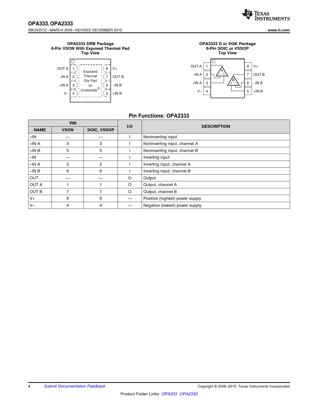

OPA333. , OPA2333. www.ti.com. OPA2333 DRB Package. OPA2333 D or DGK Package. 8-Pin VSON With Exposed Thermal Pad
OPA333 , OPA2333 www.ti.com OPA2333 DRB Package OPA2333 D or DGK Package 8-Pin VSON With Exposed Thermal Pad
OPA333
OPA333 , OPA2333
SBOS351E – MARCH 2006 – REVISED DECEMBER 2015
www.ti.com OPA2333 DRB Package OPA2333 D or DGK Package 8-Pin VSON With Exposed Thermal Pad 8-Pin SOIC or VSSOP Top View Top View
OUT A 1 8 V+ OUT A 1 8 V+ Exposed A IN A 2 7 OUT B 2 Thermal 7 OUT B - -IN A Die Pad B +IN A 3 6 IN B +IN A 3 on 6 - -IN B (2) Underside V 4 5 +IN B V 4 5 +IN B - -
Pin Functions: OPA2333 PIN I/O DESCRIPTION NAME VSON SOIC, VSSOP
+IN — — I Noninverting input +IN A 3 3 I Noninverting input, channel A +IN B 5 5 I Noninverting input, channel B –IN — — I Inverting input –IN A 2 2 I Inverting input, channel A –IN B 6 6 I Inverting input, channel B OUT — — O Output OUT A 1 1 O Output, channel A OUT B 7 7 O Output, channel B V+ 8 8 — Positive (highest) power supply V– 4 4 — Negative (lowest) power supply 4 Submit Documentation Feedback Copyright © 2006–2015, Texas Instruments Incorporated Product Folder Links: OPA333 OPA2333 Document Outline 1 Features 2 Applications 3 Description Table of Contents 4 Revision History 5 Pin Configuration and Functions 6 Specifications 6.1 Absolute Maximum Ratings 6.2 ESD Ratings 6.3 Recommended Operating Conditions 6.4 Thermal Information: OPA333 6.5 Thermal Information: OPA2333 6.6 Electrical Characteristics 6.7 Typical Characteristics 7 Detailed Description 7.1 Overview 7.2 Functional Block Diagram 7.3 Feature Description 7.3.1 Operating Voltage 7.3.2 Input Voltage 7.3.3 Internal Offset Correction 7.3.4 Achieving Output Swing to the Op Amp Negative Rail 7.3.5 DFN Package 7.4 Device Functional Modes 8 Application and Implementation 8.1 Application Information 8.2 Typical Applications 8.2.1 High-Side Voltage-to-Current (V-I) Converter 8.2.1.1 Design Requirements 8.2.1.2 Detailed Design Procedure 8.2.1.3 Application Curve 8.2.2 Precision, Low-Level Voltage-to-Current (V-I) Converter 8.2.2.1 Design Requirements 8.2.2.2 Detailed Design Procedure 8.2.2.3 Application Curves 8.2.3 Composite Amplifier 8.2.3.1 Design Requirements 8.2.3.2 Detailed Design Procedure 8.2.3.3 Application Curve 8.3 System Examples 8.3.1 Temperature Measurement Application 8.3.2 Single Operational Amplifier Bridge Amplifier Application 8.3.3 Low-Side Current Monitor Application 8.3.4 Other Applications 9 Power Supply Recommendations 10 Layout 10.1 Layout Guidelines 10.1.1 General Layout Guidelines 10.1.2 DFN Layout Guidelines 10.2 Layout Example 11 Device and Documentation Support 11.1 Device Support 11.1.1 Development Support 11.2 Documentation Support 11.2.1 Related Documentation 11.3 Related Links 11.4 Community Resources 11.5 Trademarks 11.6 Electrostatic Discharge Caution 11.7 Glossary 12 Mechanical, Packaging, and Orderable Information
