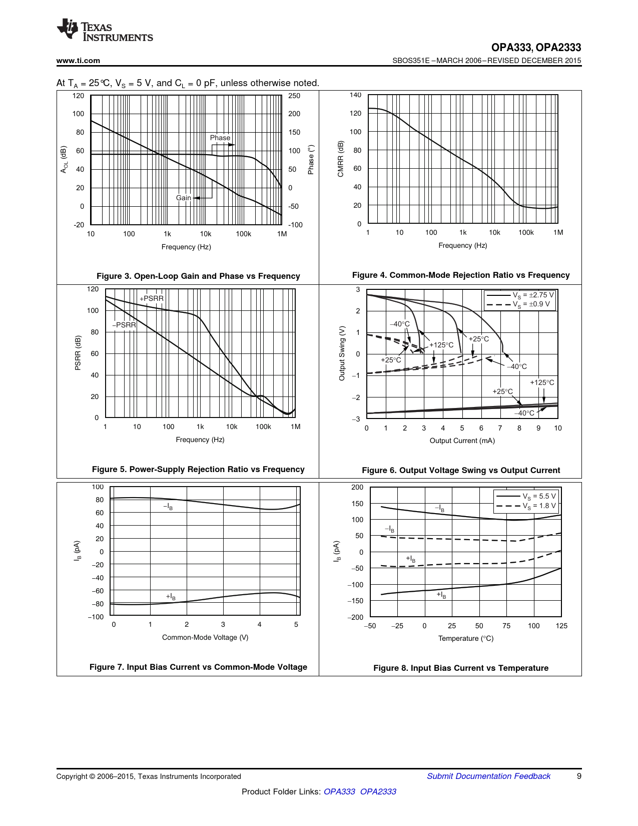

SBOS351E – MARCH 2006 – REVISED DECEMBER 2015 At TA = 25°C, VS = 5 V, and CL = 0 pF, unless otherwise noted. 120 250 140 100 200 120 80 150 100 Phase 60 100 80 (dB) LOA 40 50 60 Phase (°) CMRR(dB) 20 0 40 Gain 0 -50 20 -20 -100 0 10 100 1k 10k 100k 1M 1 10 100 1k 10k 100k 1M Frequency (Hz) Frequency (Hz)
Figure 3. Open-Loop Gain and Phase vs Frequency Figure 4. Common-Mode Rejection Ratio vs Frequency
120 3 V = 2.75 V S ± +PSRR V = 0.9 V S ± 100 2 -40°C -PSRR 80 1 +25 C ° +125 C ° 60 0 +25 C ° PSRR(dB) -40°C 40 Output Swing (V) -1 +125 C ° +25 C ° 20 -2 -40°C 0 -3 1 10 100 1k 10k 100k 1M 0 1 2 3 4 5 6 7 8 9 10 Frequency (Hz) Output Current (mA)
Figure 5. Power-Supply Rejection Ratio vs Frequency Figure 6. Output Voltage Swing vs Output Current
100 200 V = 5.5 V S 80 150 V = 1.8 V -IB -I S B 60 100 40 -IB 50 20 (pA) 0 (pA) 0 I B I B +IB -20 -50 -40 -100 -60 +I +I B B -150 -80 -100 -200 0 1 2 3 4 5 -50 -25 0 25 50 75 100 125 Common-Mode Voltage (V) Temperature ( C) °
Figure 7. Input Bias Current vs Common-Mode Voltage Figure 8. Input Bias Current vs Temperature
