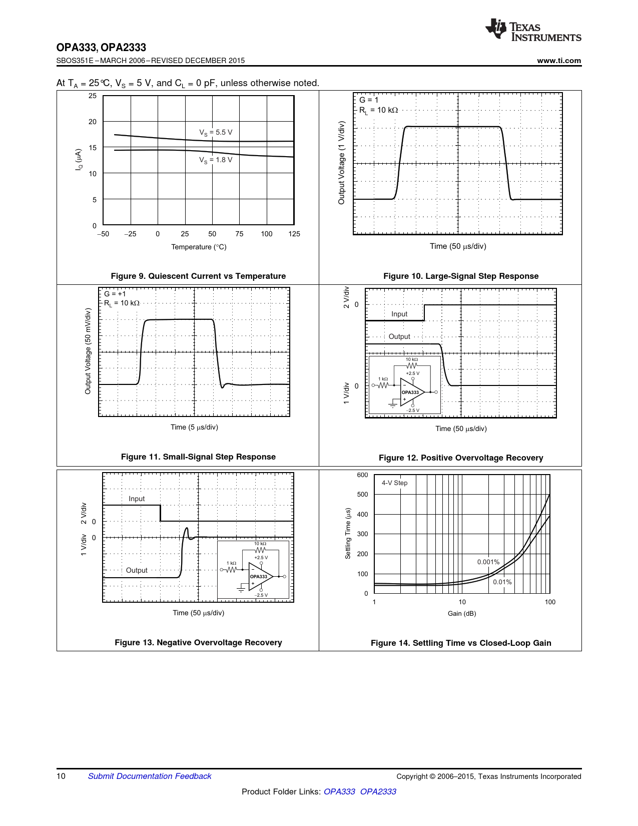

OPA333. , OPA2333. www.ti.com. Figure 9. Quiescent Current vs Temperature. Figure 10. Large-Signal Step Response
OPA333 , OPA2333
SBOS351E – MARCH 2006 – REVISED DECEMBER 2015
www.ti.com
At TA = 25°C, VS = 5 V, and CL = 0 pF, unless otherwise noted. 25 G = 1 R = 10 kW L 20 V = 5.5 V S 15 A) (m V = 1.8 V S I Q 10 oltage (1 V/div) 5 Output V 0 -50 -25 0 25 50 75 100 125 Temperature ( C) ° Time (50 ms/div)
Figure 9. Quiescent Current vs Temperature Figure 10. Large-Signal Step Response
G = +1 R = 10 kW L 2 V/div 0 Input Output 10 kW oltage (50 mV/div) +2.5 V 1 kW 0
OPA333
Output V 1 V/div -2.5 V Time (5 ms/div) Time (50 ms/div)
Figure 11. Small-Signal Step Response Figure 12. Positive Overvoltage Recovery
600 4-V Step 500 Input s) m 400 2 V/div 0 ime ( T 300 0 10 kW 1 V/div 200 +2.5 V Settling 1 kW 0.001% Output 100
OPA333
0.01% -2.5 V 0 1 10 100 Time (50 ms/div) Gain (dB)
Figure 13. Negative Overvoltage Recovery Figure 14. Settling Time vs Closed-Loop Gain
