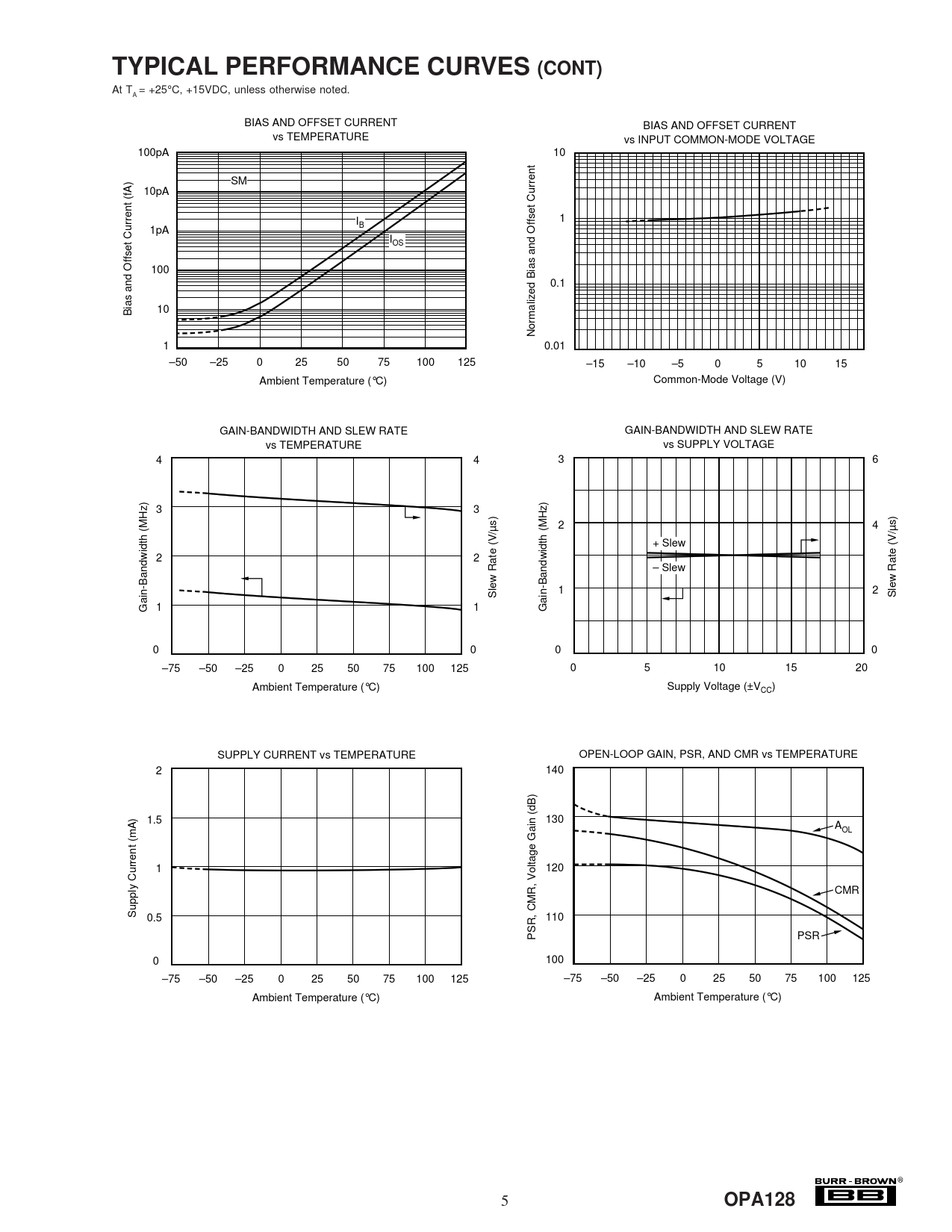

TYPICAL PERFORMANCE CURVES (CONT). OPA128
TYPICAL PERFORMANCE CURVES (CONT) OPA128
At T = +25°C, +15VDC, unless otherwise noted. A BIAS AND OFFSET CURRENT BIAS AND OFFSET CURRENT vs TEMPERATURE vs INPUT COMMON-MODE VOLTAGE 100pA 10 SM 10pA I 1 B 1pA IOS 100 0.1 10 Bias and Offset Current (fA) Normalized Bias and Offset Current 1 0.01 –50 –25 0 25 50 75 100 125 –15 –10 –5 0 5 10 15 Ambient Temperature (°C) Common-Mode Voltage (V) GAIN-BANDWIDTH AND SLEW RATE GAIN-BANDWIDTH AND SLEW RATE vs TEMPERATURE vs SUPPLY VOLTAGE 4 4 3 6 3 3 2 4 + Slew 2 2 – Slew Slew Rate (V/µs) 1 2 Slew Rate (V/µs) Gain-Bandwidth (MHz) 1 1 Gain-Bandwidth (MHz) 0 0 0 0 –75 –50 –25 0 25 50 75 100 125 0 5 10 15 20 Ambient Temperature (°C) Supply Voltage (±V ) CC SUPPLY CURRENT vs TEMPERATURE OPEN-LOOP GAIN, PSR, AND CMR vs TEMPERATURE 2 140 1.5 130 AOL 1 120 CMR Supply Current (mA) 0.5 110 PSR, CMR, Voltage Gain (dB) PSR 0 100 –75 –50 –25 0 25 50 75 100 125 –75 –50 –25 0 25 50 75 100 125 Ambient Temperature (°C) Ambient Temperature (°C) ® 5
