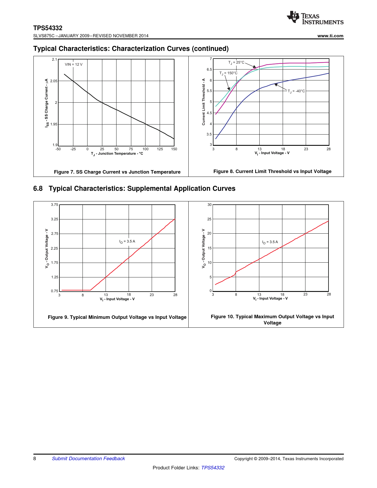

TPS54332. www.ti.com. Typical Characteristics: Characterization Curves (continued). -SSChargeCurrent-. CurrentLimitThreshold-
TPS54332
SLVS875C – JANUARY 2009 – REVISED NOVEMBER 2014
www.ti.com Typical Characteristics: Characterization Curves (continued)
2.1 7 T = 25°C VIN = 12 V J 6.5 T = 150°C J
A
2.05
A
6 m 5.5 T = -40°C J 2 5 4.5
-SSChargeCurrent-
1.95 4
CurrentLimitThreshold- I SS
3.5 1.9 3 -50 -25 0 25 50 75 100 125 150 3 8 13 18 23 28
T - Junction Temperature - °C V - Input Voltage - V J I Figure 7. SS Charge Current vs Junction Temperature Figure 8. Current Limit Threshold vs Input Voltage 6.8 Typical Characteristics: Supplemental Application Curves
3.75 30 3.25 25 2.75 20 I = 3.5 A O I = 3.5 A
oltage-V
O
oltage-V
2.25 15
-OutputV
1.75
-OutputV
10
O O V V
1.25 5 0.75 0 3 8 13 18 23 28 3 8 13 18 23 28
V - Input Voltage - V V - Input Voltage - V I I Figure 9. Typical Minimum Output Voltage vs Input Voltage Figure 10. Typical Maximum Output Voltage vs Input Voltage
