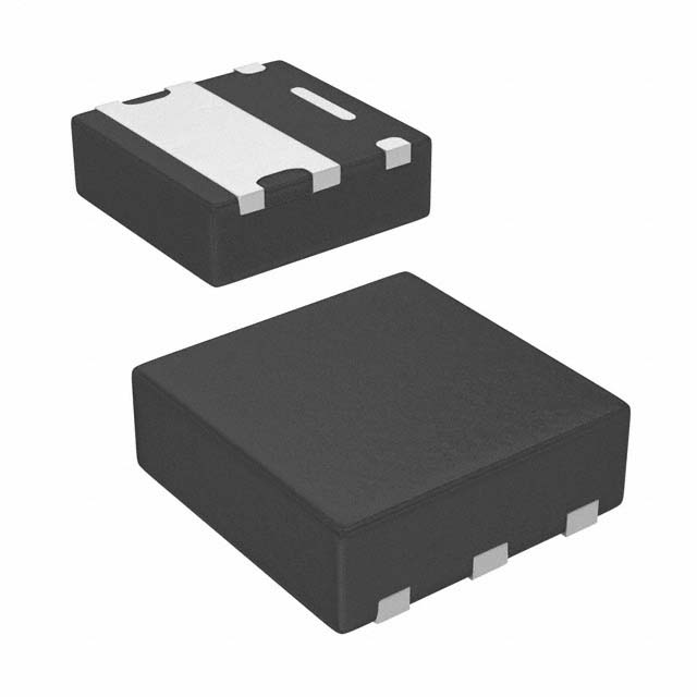

Vishay Intertechnology introduced a new 8 V n-channel TrenchFET power MOSFET featuring the industry’s lowest on-resistance for an n-channel device in the thermally enhanced PowerPAK SC-70 2 mm by 2 mm footprint area.
The new SiA436DJ offers an ultra-low on-resistance of 9.4 mΩ at 4.5 V, 10.5 mΩ at 2.5 V, 12.5 mΩ at 1.8 V, 18 mΩ at 1.5 V, and 36 mΩ at 1.2 V. These values are up to 18 % lower than previous generation solutions, and up to 64 % lower than the closest competing n-channel device in the 2-mm by 2-mm footprint area.
The SiA436DJ will be used for load switching in portable electronics such as smart phones and tablet PCs, in addition to mobile computing applications. The device’s ultra-compact PowerPAK SC-70 package saves PCB space in these applications, while its low on-resistance translates into lower conduction losses for reduced power consumption and higher efficiency.
The MOSFET’s on-resistance ratings down to 1.2 V simplify circuit design by allowing the MOSFET to work with the low-voltage power rails common in handheld devices, providing longer battery operation between charges. The SiA436DJ’s low on-resistance also means a lower voltage drop across the load switch to prevent unwanted under-voltage lockout.
