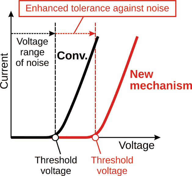

A proper quantity and distribution of sulfur in the mechanism’s SiC (Fig. 1, on right) blocks electrons near the interface to a certain extent and thereby increases threshold voltage without impacting on-resistance. A suitable atom offering such an electrical property has been strongly sought to realize devices that are not prone to malfunctioning due to the effects of external electro-magnetic noise. The new mechanism is more reliable in this regard than conventional mechanisms (Fig. 2) and still retains low on-resistance.
Relationship between SiC power semiconductor device's current and voltage
Figure 2. Relationship between SiC power semiconductor
device’s current and voltage.
