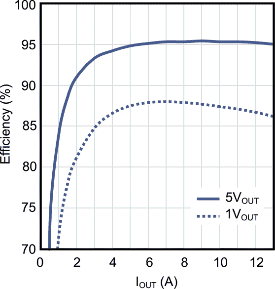

MxL7213 Efficiency vs Load Current
MxL7213 Efficiency vs Load Current.

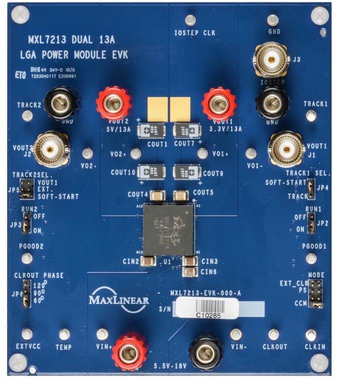

MxL7213EVB Evaluation Module
MxL7213EVB Evaluation Module.
