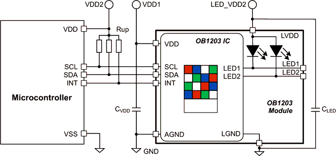

In addition to non-invasive measurement of heart rate and blood oxygen levels, the OB1203 module integrates additional sensors needed in the latest generation mobile devices, including an ambient light sensor (ALS), an RGB color sensor, a proximity sensor, and a pulse oximeter biosensor. This module comes in a tiny, optically-enhanced package at only 4.2 mm × 2 mm × 1.2 mm, and includes two LEDs, drivers, the sensors and a signal conditioning chip that outputs all sensor data on an I2C bus.
Typical Applications Circuit
Typical Applications Circuit.
