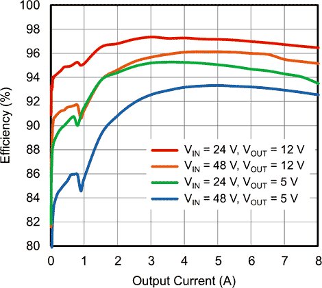

SiC477 Efficiency vs. Output Current
SiC477 Efficiency vs. Output Current.
