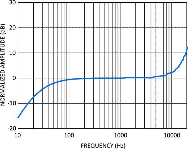

The T5808 SoundWire microphone features 66 dBA SNR and 135 dB SPL AOP at 650 µA in high quality mode (HQM), and decreases power consumption to 215 µA in low power mode (LPM). The T5808 microphone also features concurrent mode (CCM), enabling simultaneous audio streams from HQM and LPM that can seamlessly transition back and forth without audio glitches.
Typical Frequency Response
Typical Frequency Response.
