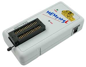

Universal memory programmer Elnec MEMprogL
MEMProgL - Universal memory programmer.
Detailed Description

Elnec MEMprogL
