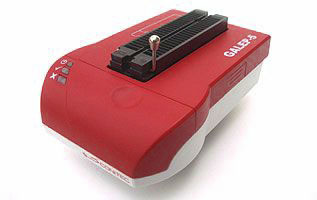

The new GALEP-5 is the first pocket sized, self-powered device programmer on the market.
Detailed Description
Due to its size and power supply independence, a GALEP-5 is the ideal solution for development and service. Its high speed allows using it as a production programmer. And with its JTAG debugging capabilities it can also be used for microcontroller development.
GALEP-5 is a universal programmer for devices of the following types: EPROM, EEPROM, FLASH memory, serial EEPROM, NV-RAM, LPC, FPGA, PLD, EPLD, GAL, PALCE, PIC, Microcontroller (MCU). More than 53,000 devices are currently supported.
With GALEP-5 you can debug all Microcontrollers with JTAG interface that are supported by the OpenOCD (On Chip Debugger) software - ARM7, ARM9, XScale, and Cortex-M3 MCUs. The chip to debug is simply put into GALEP's programming socket or connected with GALEP through a cable or ISP adapter.
Conitec GALEP-5
Technical Specifications
  • Pocket format: ca. 80 × 115 × 33 mm (+7mm socket)
  • Weight: ca. 185 g
  • 48-pin ZIF socket with 48 universal pin drivers
  • Programs low-voltage components down to 1.3V
  • USB 2.0 high-speed port
  • AC adapter plus battery compartment for high-power devices
  • 200 MIPS ARM-9 RISC processor, 64 MB RAM, 8 MB Flash
  • FPGA (50K gates, 64Kb RAM)
  • 3 linear voltage regulators for internal power supply
  • 4 switching regulators for programming voltages
  • 2 linear voltage regulators for logic levels and input threshold
  • 2 Microcontrollers for internal voltage monitoring
  • 8-channel D/A converter, 16-channel A/D converter
  • Embedded Linux 2.6 inside
