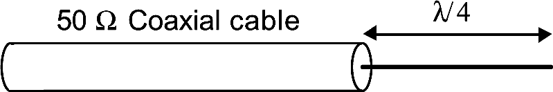

If the antenna is installed remotely from the Receiver/Transmitter module, a 50Ω coaxial cable can be used (Fig.2).
Figure 2.
The shielding of the cable should be soldered to the ground near the antenna pin.

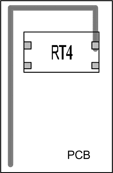

The whip can be made also as a trace on a PCB Board (Fig.3).
Figure 3.
The length of the trace may be 10% to 20% shorter than calculation, depending on the dielectric and the thickness of the board. If the unit is to be handheld, the antenna can be made a little shorter, to compensate for the effect of the hand.
Keep the antenna trace away from other circuitry and ground (5mm or more).

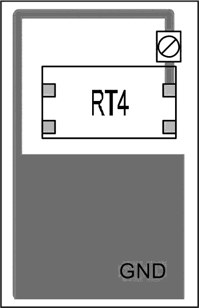

Loop Antenna
Loop antenna find application mostly at the transmitter, especially where ruggedness, size, and ease of construction are required. The loop antenna is a PCB track: one end is grounded and the other and is connected to TX/RX via a capacitor (Fig.5). The capacitor is used to tune and match the antenna.
Figure 5.
One advantage is that the loop is not easily detuned by hand effects and is not ground plane dependent. For these reasons, loops are very common in handheld transmitter such as garage door openers, car alarm, etc.
When you design the loop antenna, make the loop as large as possible, because small loop have poor gain and have a very narrow bandwidth. This makes the tuning extremely critical. Tuning is often done with a variable or a fixed capacitor.
