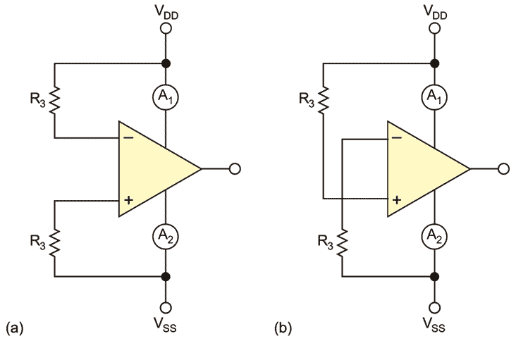

To measure supply current when the circuit is operating in open-loop mode, such as operation as a comparator, another method is used (Figure 4). Some low-noise, bipolar op amps have diodes between the inputs to protect the differential input pair, so the data sheet lists the maximum differential voltage in the absolute-maximum table as ±0.7V. Any internal series resistors usually have values of 500Ω to 2 kΩ.
The realities of the maximum-supply-current specification for op amps
Figure 4. Another method allows for measurement of supply current when the circuit is operating in open-loop mode: with a low output (a) or a high output (b).
The absolute-maximum table may state that the maximum differential voltage is plus or minus the supply voltage, but this specification does not mean that the part operates. You should consult a simplified internal schematic. If you don’t find one in the data sheet, call the manufacturer to obtain it.
In these two configurations, the choice of resistor values is more critical. The resistor values should be low enough to cause the differential input voltage to be at least 0.5V to guarantee that the output drives hard into the rail but high enough to cause no damage to the internal diodes. The chosen values limit the input current to less than 1 mA.

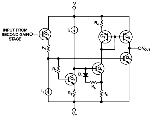

All of the bipolar rail-to-rail-output op amps have supply current greater than the maximum op-amp supply current in one or both comparator circuits. You can drive the output stage in several ways, and some methods result in a supply-current increase when driving to one rail or the other. For Texas Instruments’ OP284, the data sheet shows a simplified schematic of the second and output stages (Figure 5).
Figure 5. In the OP284, if Q5, Q3, and Q4 drive the output voltage high, the supply current will be a function of the values of R4 and R6. you select these values to maximize the op amp’s performance and minimize die area, not to enhance comparator operation.
If Q5, Q3, and Q4 drive the output voltage high, the supply current will be a function of the values of R4 and R6. You select these values to maximize the op amp’s performance and minimize die area, not to enhance comparator operation. When Q6, R1, and Q1 drive the output voltage low, R1 will determine the supply current. Again, select the values of R1, I1, and other components for op-amp performance, not comparator performance.

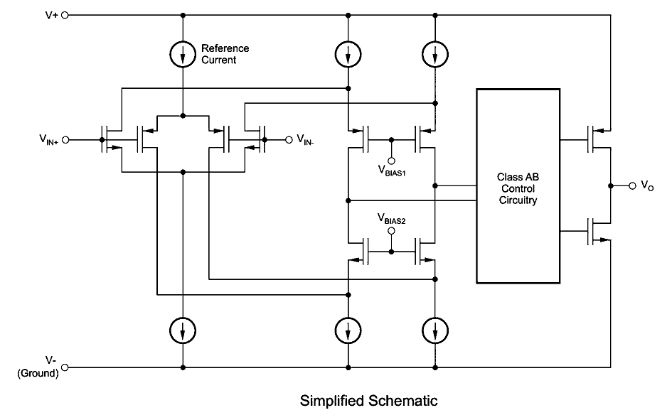

CMOS op amps have interesting behavior. In some cases, the supply current decreases when you drive it to a rail. The output stage of a CMOS op amp comprises common-source PMOS and NMOS transistors (Figure 6), and gain enters during the output stage. The gain is the transconductance times the load resistance. You can get a reasonable value of transconductance because the drive circuit sets the quiescent current to a certain value.
Figure 6. Simplified CMOS rail-to-rail OP’s schematic.
As the output drives into the rail, the drive circuit decreases the drive on the complementary transistor. Depending on the transfer characteristics from the top transistor to the bottom transistor, the current decreases. Note the wide variation in behavior among the four CMOS op amps.
