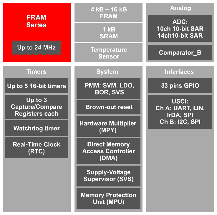

TI has integrated FRAM on a small subset of its MSP430 MCU family that is based on a 16-bit core. TI has touted the device as capable of meeting 8-bit-like requirements in cost and low power. The MSP430FR57xx FRAM MCUs (Figure 1) top out at 128 kbits of FRAM, configured 16k x 8. As is typical with MCUs, there are many options in terms of 128-kbit offerings with varied I/O functionality and integrated peripherals.
Figure 1. The MSP430FR57xx FRAM MCUs integrate as much as 128 kbits of nonvolatile memory, and family members include a variety of peripheral configurations including integration of 10-bit A/D converters with up to 14 channels.
TI offers the MCUs rated for 8 and 24 MHz clock speeds, with a maximum of 32 I/O lines. Some of the products include A/D converters with the MSP430FR5739IRHAR topping out at 14 10-bit channels. Generally, all of the MCUs in the subfamily include PWM, power-on reset, and watchdog timer peripherals, and the complement of interfaces include SPI, I²C, and a UART.
The real benefits of FRAM show through in active power consumption specs. The FRAM family dissipates 82 µA/MHz. Many of the MSP430 flash-based products use two- to three-times more power in active mode. It's only fair to point out that the specialty low-voltage flash series uses 50 percent less power, albeit those products are limited to 4 MHz operation.

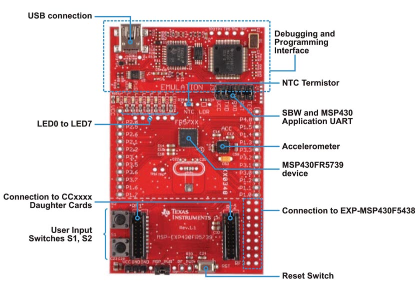

If you are new to FRAM and want to evaluate the technology, TI has several kits that may be of interest. The MSP-EXP430FR5739 FRAM Experimenter board (Figure 2) includes an MSP430FR5739 MCU with 128 kbits of FRAM. The board pictured in Figure 2 has a number of peripherals such as an accelerometer and a thermistor that might be useful in a typical application.
Figure 2. The MSP-EXP430FR5739 FRAM Experimenter board includes a three-axis accelerometer, a thermistor, LEDs, switches, and an expansion connector for connectivity-oriented daughter cards.
The MSP-FET430U40A Tool Kit Bundle includes a flash emulator and programmer that, ironically, are not required for use with the dual on-board MSP430FR5739 MCUs. However, the flash tool also includes a USB debugging interface that can be handy in system development. The CC3000 Wi-Fi FRAM Module, meanwhile, is a combination of the board from the experimented kit and a Wi-Fi module installed via a mezzanine connector.
