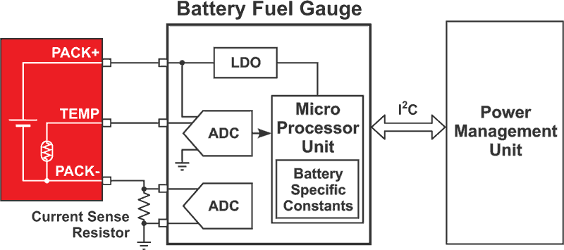

Figure 1. Block diagram of a generic battery fuel-gauging system.
Figure 1 shows the block diagram of a generic battery fuel gauge. It consists of at least two analog-to-digital converters (ADCs), one of which is dedicated for measuring the battery current. The second ADC is multiplexed and can be used to measure battery voltage, battery temperature or used as a general purpose ADC. The measured battery voltage, current, and temperature are sent to a microprocessor which implements the fuel-gauging algorithm. The microprocessor contains battery chemistry specific information, such as cell impedance or cell capacity as a function of voltage, in its non-volatile memory. An on-chip or external regulator provides a regulated supply to power the microprocessor, ADCs, and other support circuitry. The battery fuel gauge communicates with the rest of the system using standard protocols such as I2C communication.

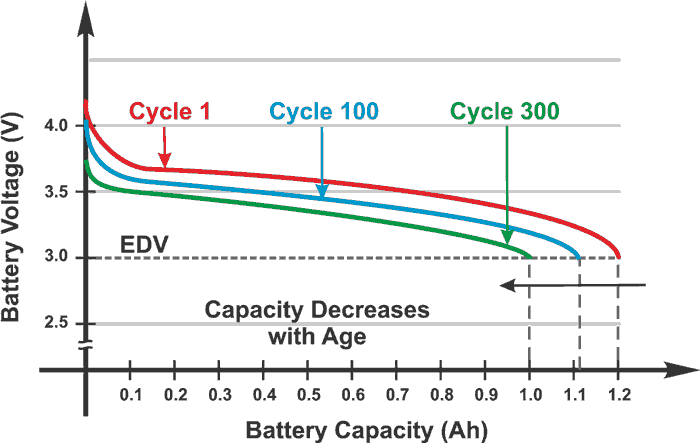

Figure 2. Cell capacity plotted as a function of the open circuit voltage over multiple charge-discharge cycles. As the cell ages, capacity is reduced and the end-of-discharge-voltage (EDV) is reached at lower capacities.

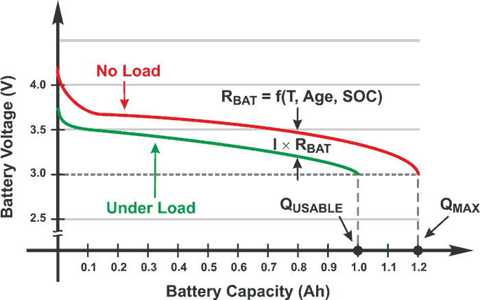

Using the circuitry shown in Figure 1, the simplest algorithm to estimate the battery capacity is to measure the battery voltage and use Figure 2 to estimate the battery capacity. Figure 2 shows a typical battery voltage curve of a Lithium-Ion (Li-Ion) battery as a function of battery capacity. Given a battery voltage, the battery capacity can be obtained from this graph. Figure 2 also shows that battery capacity decreases as the number of charge-discharge cycles increases. The voltage-based technique is simple to implement and provides an accurate value of maximum battery capacity (QMAX) when there is no load on the battery. However, the actual usable battery capacity (QUSABLE) is less than the maximum capacity because of the battery’s internal impedance (Figure 3). An average value of the battery impedance (RBAT) can be used to estimate the usable capacity, but this estimate could have large errors because RBAT is a function of battery temperature, age, and state-of-charge (SoC). While in principle a large multidimensional lookup table can be used to correct for battery resistance, this requires extensive characterization of the battery and circuitry for the computation of the resistance.
Fundamentals of battery fuel-gauging
Figure 3. Cell capacity plotted as a function of battery voltage under load and no-load conditions. The usable capacity (QUSABLE) is reduced because of the cell
impedance (RBAT).
