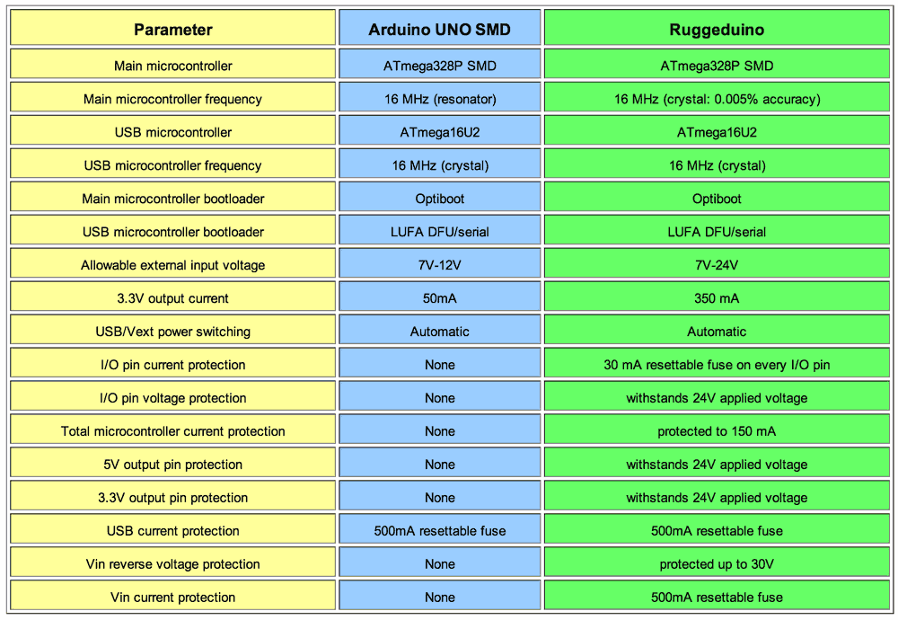

The Ruggeduino is directly compatible with the Arduino UNO SMD. It uses the same microcontroller (ATmega328P), same Arduino GUI, same USB interface (ATmega16U2), same clock frequency, same connectors and connector positions, and so on. The Ruggeduino adds several features to make it more rugged, making sure that it will last a long time.
This Table 1 shows a quick comparison between the Arduino UNO SMD and the Ruggeduino.
Table 1. Quick comparison between the Arduino UNO SMD and the Ruggeduino.

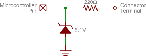

I/O Pin Protection
Every I/O pin is protected by a 5.1 V zener diode and 220 ohm 30 mA PTC (resettable fuse). The equivalent circuit is shown in Figure 2.
Ruggeduino - Ruggedized Arduino-compatible microcontroller board
Figure 2. The equivalent circuit of Ruggeduino I/O Pin Protection.
This protection circuit means:
  • Every I/O pin can have up to 24 V applied to it and will still not be damaged.
  • Every I/O pin can be short-circuited to ground and will still not be damaged
  • Every I/O pin can be short-circuited to another I/O pin and will still not be damaged

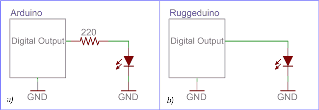

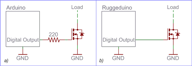

In addition, the 220 ohm PTC can take the place of series resistors in many applications, such as lighting LED’s, driving transistors, and so on. Here is an example of an Arduino driving a transistor through a series resistor, and how the Ruggeduino simplifies the circuit due to its built-in 220 ohm series resistance (Figure 3).
Figure 3. Ruggeduino simplifies the circuit due to its built-in 220 ohm series resistance.
Similarly, you can connect LED’s directly to Ruggeduino digital outputs without any resistors and not worry about destroying them due to excessive current (Figure 4).
Figure 4. You can connect LED’s directly to Ruggeduino digital outputs without any resistors.

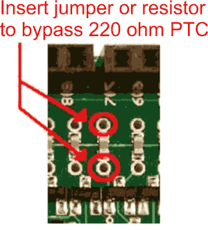

If you do have an application where this built-in 220 ohm resistance is not wanted, you can easily change it. Every I/O pin has through-hole pins surrounding its PTC fuse that can be jumpered with either a wire for 0 resistance or with a standard resistor (Figure 5). Here is a picture showing how to bypass the 220 ohm PTC for pin D7.
Figure 5. Every I/O pin has through-hole pins surrounding its PTC fuse that can be jumpered with either a wire
for 0 resistance.

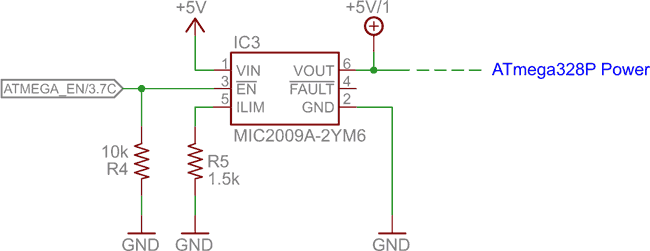

Total Microcontroller Current Protection
It is not enough to limit the current of each I/O pin, the total current sourced by the microcontroller must also be limited to limit its power dissipation. Current-limiting device IC3 on the schematic does this: the microcontroller total current is limited to 150mA (typical) no matter how many pins are sourcing current (Figure 6).
Figure 6. Current-limiting device IC3: The microcontroller total current is limited to 150mA no matter how many pins are sourcing current.
The MIC2009A limits the current from the +5 V input to the +5 v/1 output, which is used to power the ATmega328P. As soon as the ATmega328P pins start sourcing more than 150 mA the +5 V/1 voltage is automatically reduced by the MIC2009A to limit the current to this level. You can short every one of the ATmega328P’s I/O pins to ground and set them all high in your program and you still won’t destroy the microcontroller. Don’t try that with an Arduino!

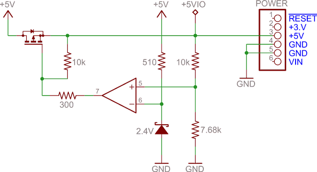

5V Output Protection
The 5 V output connector pin is current-limit protected by the thermal shutdown feature of the on-board 5 V regulator. In addition, this pin is protected against applied overvoltage. Any voltage at this pin above 5.5 V (typical) will disconnect the pin from the rest of the Ruggeduino circuitry, preventing this damaging voltage from reaching the other components.
Applied voltages of up to 24V are blocked.
The schematic below (Figure 7) represents the output protection circuitry. The comparator is constantly checking the output pin +5 VIO against a reference voltage set by the 2.4 V zener diode. If the +5 VIO voltage becomes too high, the comparator trips and turns off the MOSFET to disconnect the microcontroller’s +5 V supply from the overvoltage applied at +5 VIO.
Figure 7. +5V output protection circuitry.

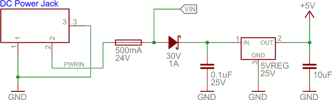

Vext Fuse and Vin Blocking Diode
The external DC power jack input is fused on the Ruggeduino (500 mA PTC resettable fuse). The main purpose of this fuse is to protect the Vin output when used to provide power to external devices. The on-board 5 V regulator provides additional current limiting (thermal limiting) to the Ruggeduino circuitry.
On the Arduino Uno, the Vin output pin has no reverse blocking diode. If you apply power to the Arduino through this pin and reverse the voltage by mistake, you will destroy the Arduino. On the Ruggeduino the blocking diode comes after the Vin input thus prevents this failure mode.
Figure 8. Vin and Vext protection circuitry on the Ruggeduino.
 The schematic below (Figure 8) shows the Vin and Vext protection circuitry on the Ruggeduino.

  • What connection goes to the (Atmega_EN/3.7C) enable pin of MIC2009A ? are the eagles design files also available for download ?
