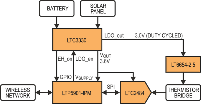

Figure 1 shows the block diagram of the design. The temperature sensor is based on a thermistor biased by a low noise LT6654 voltage reference. The 24-bit delta-sigma ADC LTC2484 reads the thermistor voltage and reports the result via SPI interface.
| Figure 1. | A Wireless temperature sensor is formed by connecting a wireless radio module to an ADC, reference and thermistor. The circuit is powered by an energy harvester that can take power from a battery or solar panel. |
The LTP5901 is the radio module that contains not only the radio, but also the networking firmware needed to automatically form an IP-based mesh network. In addition, the LTP5901 has a built-in microprocessor which reads the LTC2484 ADC SPI port, and manages the power sequencing for the signal chain components.
The LTC3330 is a low-power dual switch-mode power supply that derives power from the solar panel when enough light is available and reverts to using the battery when needed to maintain output voltage regulation. The LTC3330 also includes an LDO which is used to duty-cycle power to the temperature sensor.

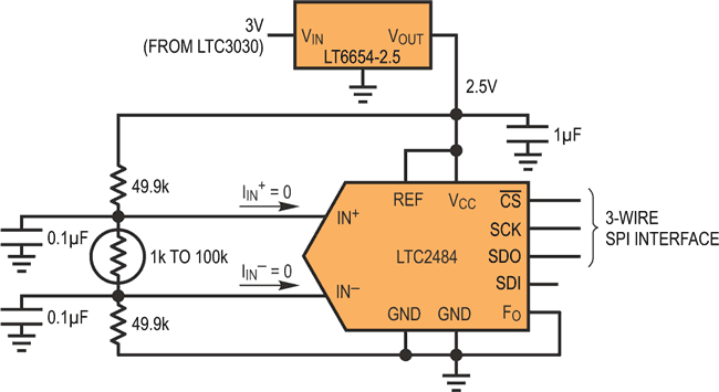

This design uses a thermistor to measure temperature. Thermistors are well suited to read temperatures in a range well beyond typical ambient temperatures of interest to humans. Thermistors are resistors with a strongly negative temperature coefficient. For example, part number KS502J2 (by US Sensor) is 5k at 25 °C and changes from 88k to 875 Ohm over the -30°C to +70°C temperature range.
The thermistor is connected in series with two accurate 49.9k resistors, and biased up by precision voltage reference LT6654 (Figure 2). The LTC2484 delta-sigma ADC measures the resistor divider ratio with 24-bit resolution. The ADC total unadjusted error is 15 ppm, which for this thermistor slope corresponds to a temperature uncertainty of less than 0.05°C. This thermistor is specified with an accuracy of 0.1 °C, so that without any calibration we can measure the temperature to that accuracy.
| Figure 2. | LTC2484 24-bit ADC reads the thermistor voltage. Because the input common-mode voltage remains centered, the Easy Drive ADC draws no input current, which makes for an easy and accurate ratiometric reading. |
The ADC noise is less than 4 µVpp, which corresponds to less than a 0.005 °C change in temperature. Therefore, with a calibration step, this system could be used to measure temperature to extremely fine resolution. Since the ADC measures the ratio of thermistor voltage to reference voltage, strictly speaking the reference does not need to be accurate. However, it must be low noise, because variations in reference voltage during the ADC conversion period could produce errors.
The LTC2484 ADC features an Easy DriveTM input structure. This means that net differential sampling currents during a conversion period are nearly zero. As a result, no measurement errors are induced from input sampling current flowing through the resistive thermistor network, which means no separate op amp buffer is needed. Bypass capacitors provide a low impedance path at high frequency. In many cases it is not needed to measure temperature constantly, but rather once per second or even just once per minute. It makes sense to save power during the times that the system does not measure temperature. This application circuit does exactly that, as described below.
The resistor network draws up to 25 µA from the 2.5 V reference. To avoid this power loss between measurements, the power supply to the reference is duty-cycled to be on only during measurements. The RC time constant at the input of the ADC is about 5 msec. By turning on the power 80 msec prior to taking a measurement, full settling at the ADC input is ensured.
In fact, since both input nodes turn on at the same slope, readings are accurate well before the theoretical settling time. The LT6654 is powered from the 3 V LDO output of the LTC3330. The LTP5901 microprocessor drives the LDO enable pin of the LTC3330 high and low at the correct times before and after performing a temperature reading.
The LTC2484 automatically enters sleep mode when not converting. The 1 µA sleep current is low compared to the already low power of the wireless radio. Therefore, it is not necessary to duty-cycle the power supply to the ADC. By keeping the ADC permanently powered from the same supply voltage as the LTP5901, the logic levels at the SPI interface are ensured to be the same, which helps keep the design simple.
After providing a conversion result through the SPI port, the LTC2484 automatically starts a new conversion, and stores the result in its internal register until the user asks to read it again. This can be handy in systems that require temperature to be read very frequently. However, some ultra-low power applications may wait a long time in between readings. To ensure that the temperature that is communicated to the user is always a ‘fresh’ reading, this application first toggles the /CS and SCK pins to flush-out the ‘stale’ temperature reading from the ADC register.
This automatically starts a new temperature conversion. The microprocessor waits until the conversion is completed, and then reads the result through the SPI port. Even though a new temperature reading will automatically start again, the system proceeds to shut down the thermistor network (by turning off the LDO) since the result of this extra reading will be subsequently ignored.

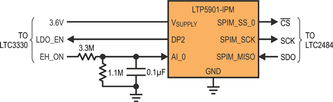

The LTC3330 provides an output flag (EH_ON) which tells the system whether power is being drawn from the battery or from the solar panel. It can be informative for the end user to have real-time access to this information. Therefore, we let the microprocessor inside the wireless radio read this output flag and transmit it through the network, along with the temperature data itself.
The logic level for this EH_ON output is referred to an internal bias voltage of the LTC3330, which varies depending on operating mode and can be higher than 4 V. Rather than connecting that output pin directly to the lower-voltage logic input of the wireless radio, we divide it down and feed it into a built-in 10-bit ADC that is part of the microprocessor. In this case, we just use that ADC as a comparator to indicate which power source the LTC3330 is using.

The LTP5901 performs two functions in this application: wireless networking and housekeeping microprocessor (Figure 6). When multiple nodes of LTP5901 are powered up in the vicinity of a network manager, the nodes automatically recognize each other and begin forming a wireless mesh network. The entire network is automatically time-synchronized, which means that each radio is powered on only for very short, specific time intervals.
| Figure 6. | The LTP5901-IPM requires remarkably few connections to run this entire application. All wireless networking functions, including firmware and RF circuitry, are already built in. A 3-wire SPI master talks to the LTC2484 SPI port. A GPIO pin (DP2) controls the power sequencing to the sensor. The built-in ADC acts as a convenient level translator to read the energy harvesting status flag EH_ON from the LTC3330. |
As a result, each node can function not only as a source of sensor information, but also as a routing node to relay data from other nodes toward the manager. This creates a highly reliable, low power mesh network, where multiple paths are available from each node to the manager, even though all nodes, including the routing nodes, operate on very low power. A typical range for this radio technology is 100 m between nodes, with even more range possible in favorable outdoor conditions.
The LTP5901 includes an ARM Cortex-M3 microprocessor core, which runs the networking software. In addition, this core can be programmed through user-supplied firmware to perform tasks specific to the user application. As a result, many applications can be built without needing any third-party microprocessor.
In this example, the microprocessor inside the LTP5901 manages the power sequencing to the temperature sensor by turning the LDO of the LTC3330 on and off at the correct times, so as to conserve power between temperature readings. The LTP5901 communicates directly to the SPI port of the 24-bit ADC which reads the temperature sensor.
Finally, the LTP5901 reads the power status output flag (EH_on) from the LTC3330, which indicates whether solar light or the battery is used to power the circuit.
