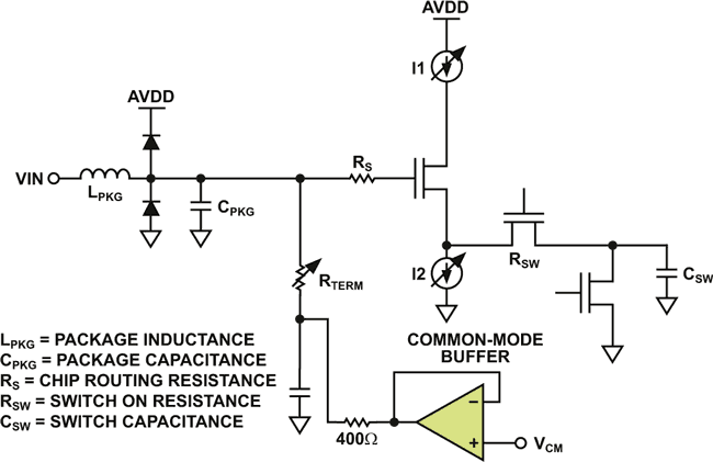

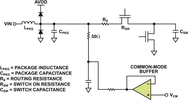

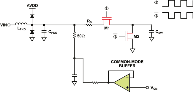

RF-sampling ADCs are implemented with several different designs, the most common being the pipelined architecture, which cascades several stages to convert the analog signal to digital. The first stage, which is the most critical, can be buffered or unbuffered. The choice of which to use depends on design requirements and performance targets. For example, a buffered ADC usually offers better SFDR across frequency but consumes more power than an unbuffered ADC.
| Figure 1. | Equivalent circuit of an unbuffered RF-sampling ADC input. |
The front-end design will also change according to whether the ADC is buffered or unbuffered. The additional series resistance needed for unbuffered ADCs to handle the input charge kickback would also improve SFDR performance. Figure 1 and Figure 2 show simplified equivalent input circuits of the AD9625 unbuffered and AD9680 buffered RF-sampling ADCs. Only the single-ended inputs are shown for simplicity.

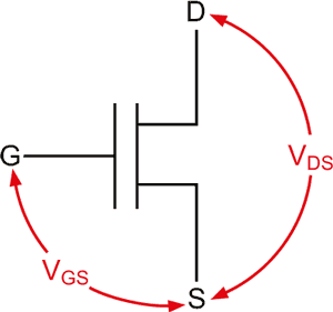

The failure mechanism will differ for buffered and unbuffered ADCs, but failure usually occurs when the maximum allowable gate-source voltage (VGS) or drain-source voltage (VDS) is exceeded. These voltages are illustrated in Figure 3.
| Figure 3. | Critical voltages for MOS transistor. |
For example, if VDS exceeds the maximum allowable voltage, it causes a VDS breakdown failure, which usually occurs when the MOSFET is in the off state and an excessive voltage is applied to the drain with respect to the source. If VGS exceeds the maximum allowable voltage, it causes a VGS punch through, also known as oxide breakdown. This usually happens when the MOSFET is on and an excessive voltage is applied to the gate with respect to the source.

Figure 4 shows an unbuffered ADC input. The sampling process is controlled by out-of-phase clock signals Φ and Ф, which are the sample/hold signal for MOSFET M1 and the reset signal for MOSFET M2. When M1 is on, M2 is off, and capacitor CSW tracks the signal (sample or track mode). When M1 is off, M2 turns on after the comparators in the MDAC have made a decision, resetting the capacitor CSW. This prepares the sampling capacitor for the next sample during the sampling phase. This circuit normally works like a well-oiled machine.
| Figure 4. | Failure mode in an unbuffered ADC input. |
High-voltage inputs, however, expose the circuit to stresses that violate the drain-source voltage limit for M2. When a high-voltage input is sampled (M1 is on, M2 is off), M2 is exposed to a large VDS. M2 is off for less than one-half cycle of the sampling clock, but even this transient exposure can deteriorate the reliability of the circuit and render the ADC useless over time. M1 is exposed to a large VDS when in reset mode (M1 off, M2 on), as the input signal is present on its drain.

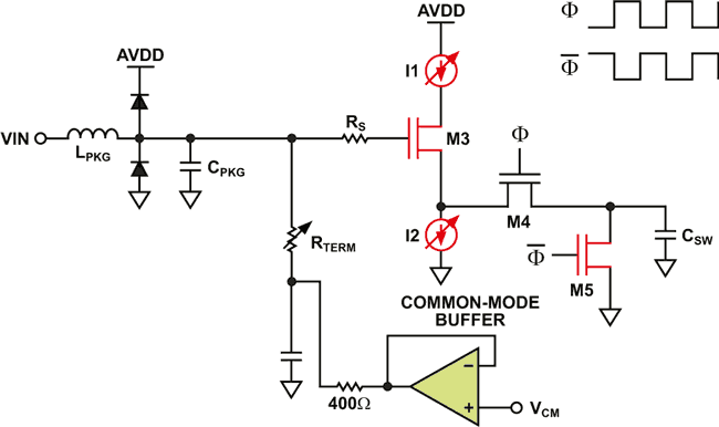

Figure 5 shows a buffered ADC input. The same clock scheme applies for the sampling and reset signals. Regardless of the phase, when the gate of Buffer M3 is exposed to a high-voltage input, it stresses the circuitry that creates currents I1 and I2. Current Source I1 is implemented with a PMOS transistor, whereas I2 is implemented with an NMOS transistor. A high voltage at the gate of M3 causes excessive VDS on both I1 and I2 MOSFETs. In addition, a high voltage on the gate of M3 can result in oxide breakdown (punch through).

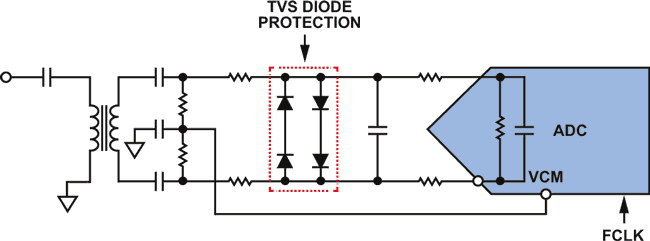

The excess voltage can be limited by transient-voltage-stabilizer (TVS) diodes, but they compromise ADC performance during normal operation. Figure 6 shows a circuit that uses TVS diodes to protect against overvoltage conditions.
| Figure 6. | ADC front-end circuit with TVS diode protection. |
Although the TVS diodes protect the ADC inputs by clamping the excess voltage, they severely degrade the harmonic performance. Figure 7 shows a comparison FFT of a 14-bit, 250-MSPS bufferless ADC with a 30-MHz, –1 dBFS input with and without the TVS diode in the front end.

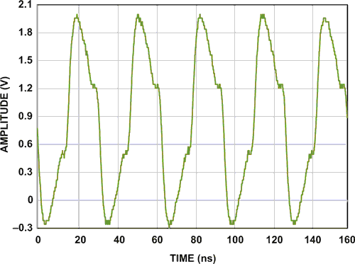

The TVS diodes especially degrade the odd harmonics because they act as reverse-biased diodes when not clamping. This PN diode has a junction capacitance, CJ0, that interacts with the nonlinear kickback current generated by the switching action inside the ADC to create a voltage that mixes with the analog input signal. The mixed signal gets sampled inside the ADC and generates a significant third-order harmonic. A time domain plot of the overvoltage condition (Figure 8) shows the clipping action of the TVS diodes. This doesn’t mean that the TVS diode is unsuitable for ADC input protection, but only that the diode specifications must be carefully considered so as to obtain the required performance. A more thorough look is needed in selecting the type of diode and its parameters.
| Figure 8. | Clipped signal due to TVS diode protection in front-end circuit. |

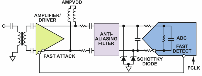

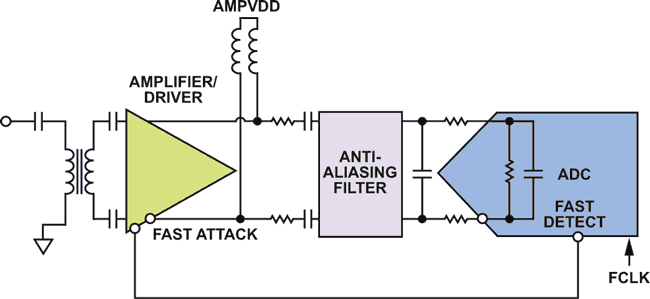

As bandwidths and sample rates have hit the GHz and GSPS range, RF-sampling ADCs simplify radio receiver designs because they do not require as many mixing stages in front of the ADC, but this leaves the ADC inputs vulnerable to overvoltage stresses. Figure 9 shows a typical amplifier driven front-end design for an RF-sampling ADC. The new generation of amplifiers specifically designed to interface with these ADCs have a fast-attack input, which can be configured via the serial peripheral interface (SPI) to attenuate the outputs to a predetermined gain. The fast-attack pin can be configured to respond to the fast-detect output from the RF-sampling ADC. The ADA4961 is an example of the new generation of amplifiers with the fast-attack feature. The AD9680 and AD9625 are examples of RF-sampling ADCs that have the fast-detect feature.
The topology of Figure 9 is good as long as the input voltages are within range. If, for example, this receiver path is exposed to a sudden burst of high voltage at the input, the outputs are going to rise to the voltage of the amplifier’s supply rail (5 V, in this case). This presents a huge swing in excess of the absolute maximum-rated voltage at the inputs of the ADC. The fast detect has some latency (28 clock cycles or 28 ns for the AD9680-1000), so by the time the fast-detect logic output tells the amplifier to assert a fast attack, the ADC has already been exposed to the high voltage for a few clock cycles. This might degrade the ADC’s reliability, so system designs that can’t tolerate this risk will need a secondary mode of protection. A fast-acting Schottky diode with very low device and parasitic capacitance is useful in these situations. Key parameters for specifying the diode can be found in the data sheet.
| Figure 9. | Amplifier with fast attack driving RF-sampling ADC with fast detect. |
Reverse breakdown voltage (VBR) – the maximum input voltage at the AD9680 input pins – is about 3.2 V relative to AGND, so a reverse breakdown voltage of 3 V is chosen for the diode.

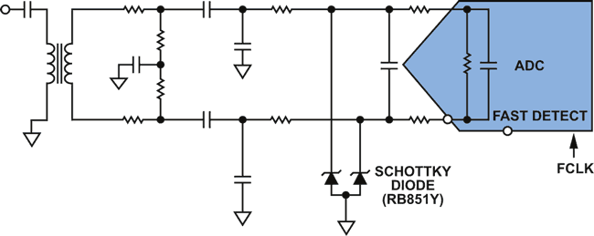

Figure 10 shows a passive front end with a Schottky diode inserted in front of the ADC. The passive front end makes it easy to demonstrate that the Schottky diode can protect the ADC inputs without compromising the ac performance.
| Figure 10. | Passive front-end circuit showing RF-sampling ADC and Schottky diode. |

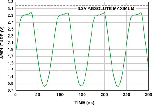

The RF-sampling ADC was tested to input frequencies up to 2 GHz, so an RF Schottky diode was chosen (RB851Y). Table 2 shows the key parameters of the RB851Y that make it suitable for the application. Tests were conducted to show that the diodes prevented the ADC inputs from exceeding the absolute maximum voltage rating of 3.2 V with respect to AGND.
| Figure 11. | Single-ended ADC input being clipped by the Schottky diode. |

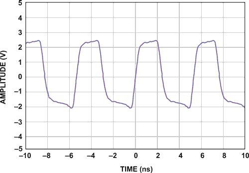

Figure 11 shows a single-ended input (VIN+ pin of the ADC) exposed to a high voltage at 185 MHz. The Schottky diode clamps the voltage to around 3.0 V relative to AGND, preventing the ADC inputs from reaching the 3.2-V limit. Figure 12 shows a differential signal at the input of the AD9680 being clipped by the Schottky diodes.

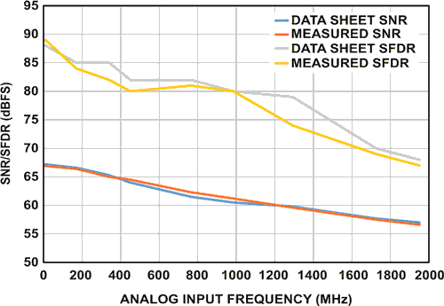

Next, we measured performance during normal operation. The AD9680 was controlled as per data sheet recommendations, but the inputs were modified as shown in Figure 10. The analog input frequency was varied from 10 MHz to 2 GHz. The ultralow value of CJ0 should not impact the ADC’s SNR and SFDR performance.
| Figure 12. | AD9680 differential inputs clipped by Schottky diodes. |
The Schottky diodes do not affect the SNR at all, but the SFDR deviates from the expected value at some frequencies, as shown in Figure 13. This may be caused by a mismatch in the differential signal or kickback from the ADC. The evaluation board is designed for a wide band, from dc to 2 GHz, so while it does a good job overall across the entire band, some components may interact with the Schottky diodes at certain frequencies.

Most applications do not use the entire 2-GHz band, so it is possible to tune the front end to the required signal bandwidth of interest by modifying the input for overvoltage protection. Careful selection of the Schottky diode can protect the ADC inputs, allowing a system designer to implement an amplifier driven front-end circuit using the latest fast-attack and fast-detect features, as shown in Figure 14.
| Figure 14. | ADA4961 driving the AD9680 showing RF-sampling ADC and Schottky diodes. |
