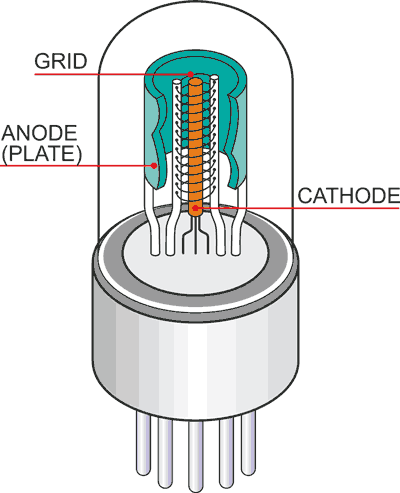

Chip in a Bottle:
 The simplest vacuum tube capable of amplification
is the triode, so named because it contains three
electrodes: a cathode, an anode, and a grid. Typically,
the structure is cylindrically symmetrical, with the
cathode surrounded by the grid and the grid
surrounded by the anode. Operation is similar to that
of a field-effect transistor, here with the voltage
applied to the grid controlling the current flow
between the other two electrodes. (Triode tubes
often have five pins to accommodate two additional
electrical connections for the heated filament.)

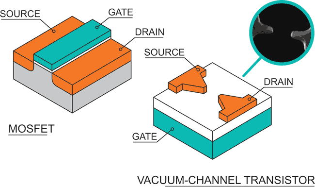

Transistorizing the Vacuum Tube:
A vacuum-channel transistor closely resembles an ordinary metal-oxide
semiconductor field-effect transistor or MOSFET [left]. In a MOSFET, voltage
applied to the gate sets up an electric field in the semiconductor material below.
This field in turn draws charge carriers into the channel between the source
and drain regions, allowing current to flow. No current flows into the gate, which
is insulated from the substrate below it by a thin oxide layer. The vacuum-channel
transistor the authors developed [right] similarly uses a thin layer of oxide to
insulate the gate from the cathode and anode, which are sharply pointed to intensify
the electric field at the tips.

But how do you turn this new kind of transistor on and off? With a triode vacuum tube, you control the current flowing through it by varying the voltage applied to the grid – a meshlike electrode situated between the cathode and the anode. Positioning the grid close to the cathode enhances the grid’s electrostatic control, although that close positioning tends to increase the amount of current flowing into the grid. Ideally, no current would ever flow into the grid, because it wastes energy and can even cause the tube to malfunction. But in practice there’s always a little grid current.
To avoid such problems, we control current flow in our vacuum-channel transistor just as it’s done in ordinary MOSFETs, using a gate electrode that has an insulating dielectric material (silicon dioxide) separating it from the current channel. The dielectric insulator transfers the electric field where it’s needed while preventing the flow of current into the gate.
So you see, the vacuum-channel transistor isn’t at all complicated. Indeed, it operates much more simply than any of the transistor varieties that came before it.

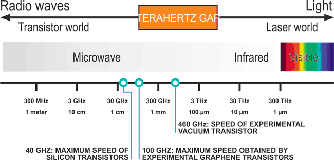

Filling the Gap:
Vacuum-channel transistors hold the promise of being able to operate at frequencies above
microwaves and below infrared – a region of the spectrum sometimes known as the terahertz
gap because of the difficulty that most semiconductor devices have operating at those
frequencies. Promising applications for terahertz equipment include directional high-speed
communications and hazardous-materials sensing.
Such frequencies, which run from about 0.1 to 10 terahertz, are useful for sensing hazardous materials and for secure high-speed telecommunications, to give just a couple of possible applications. But terahertz waves are difficult to take advantage of because conventional semiconductors aren’t capable of generating or detecting this radiation. Vacuum transistors could – pardon the expression – fill that void. These transistors might also find their way into future microprocessors, their method of manufacture being completely compatible with conventional CMOS fabrication. But several problems will need to be solved before that can happen.
Our prototype vacuum transistor operates at 10 volts, an order of magnitude higher than modern CMOS chips use. But researchers at the University of Pittsburgh have been able to build vacuum transistors that operate at just 1 or 2 V, albeit with significant compromises in design flexibility. We’re confident we can reduce the voltage requirements of our device to similar levels by shrinking the distance between its anode and cathode. Also, the sharpness of these electrodes determines how much they concentrate the electric field, and the makeup of the cathode material governs how large a field is needed to extract electrons from it. So we might also be able to reduce the voltage needed by designing electrodes with sharper points or a more advantageous chemical composition that lowers the barrier for the electron escaping from the cathode. This will no doubt be something of a balancing act, because changes made to reduce operating voltage could compromise the long-term stability of the electrodes and the resultant lifetime of the transistor.
