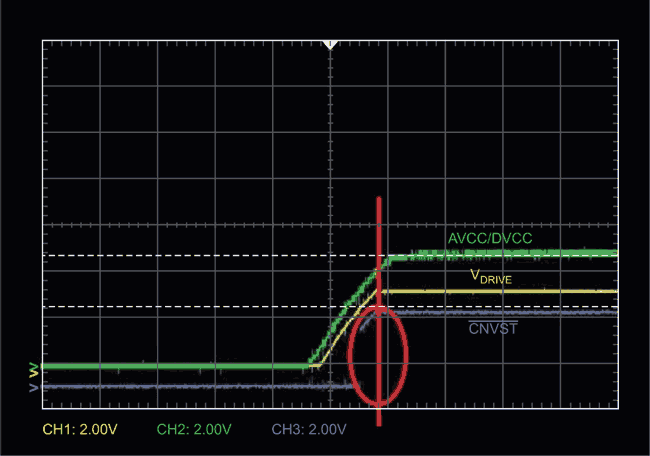

No digital pin should toggle until all the power supplies have been fully established. For SAR ADCs, the convert start pin, /CNVST, may be sensitive to noise. Figure 1 shows an example in which the host cPLD brings /CNVST high while AVCC, DVCC and VDRIVE are still ramping. This might put the AD7367 into an unknown state, so the host should keep /CNVST low until the supplies are all fully established.

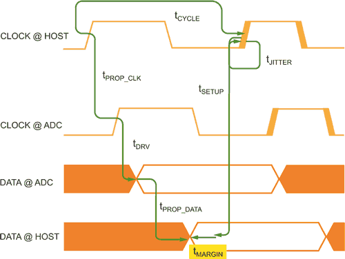

After a conversion has finished, the host can read the data via a serial or parallel interface. To read the data correctly, follow a specific timing strategy, such as which mode to use for the SPI bus. Do not violate the digital interface timing specifications, especially the setup and hold times of the ADC and the host. The maximum bit rate is determined by the whole cycle, not just the minimum specified clock period. Figure 2 and the following equations show an example of how to calculate the setup and hold timing margin. The host sends the clock to the ADC and reads the data output from the ADC.
tCYCLE = tJITTER + tSETUP + tPROP_DATA + tPROP_CLK + tDRV + tMARGIN,
where
tCYCLE: Clock period = 1/fCLOCK
tJITTER: Clock jitter
tSETUP: Host setup time
tHOLD: Host hold time
tPROP_DATA: Data propagation delay along the transmit line from ADC to host
tPROP_CLK: Clock propagation delay along the transmit line from host to ADC
tDRV: Data output valid time after clock rising/falling edge
tMARGIN: Margin time, ≥ 0 means the setup time or hold time is met; < 0 means the setup time or hold time is not met.
| Figure 2. | Setup and hold timing margin. |
The setup margin for the host is
tMARGIN_SETUP = tCYCLE, MIN – tJITTER – tSETUP – tPROP_DATA – tPROP_CLK – tDRV, MAX.
The setup time equation defines the minimum clock period time or maximum frequency in terms of the maximum system delay terms. It must be ≥ 0 to meet the timing specifications. Increase the period (reduce the clock frequency) to handle excessive system delays. For buffers, level shifters, isolators, or other additional components on the bus, add the extra delay into tPROP_CLK and tPROP_DATA.
Similarly, the hold margin for the host is
tMARGIN_HOLD = tPROP_DATA + tPROP_CLK + tDRV – tJITTER – tHOLD.
The hold time equation defines the minimum system delay requirements to avoid logic errors due to hold violations. It has to be ≥ 0 to meet the timing specifications.

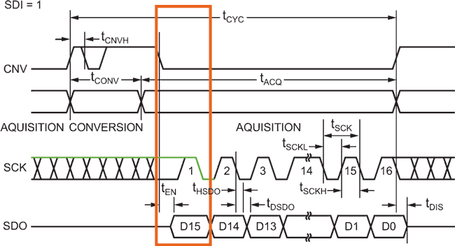

Many of ADI’s SAR ADCs with an SPI interface clock the MSB from the falling edge of CS or CNV, while the remaining data bits follow the falling edge of SCLK, as shown in Figure 3. When reading the MSB data, use ten in the equations instead of tDRV.
| Figure 3. | SPI timing of AD7980 3-wire CS mode. |
Thus, in addition to the maximum clock rate, the maximum operating speed of the digital interface also depends on the setup time, hold time, data output valid time, propagation delay, and clock jitter.

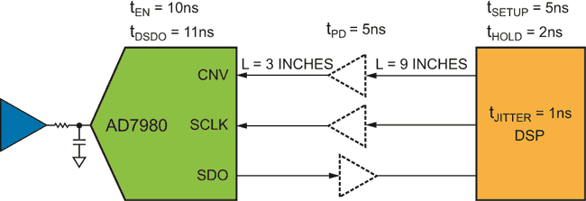

Figure 4 shows a DSP host accessing the AD7980 in 3-wire CS mode, with VDRIVE = 3.3 V. The DSP latches the SDO signal on the falling edge of SCLK. The DSP specifies 5 ns minimum setup time and 2 ns minimum hold time. For a typical FR-4 PC board, the propagation delay is about 180 ps/in. The propagation delay of the buffer is 5 ns. The total propagation delay for CNV, SCLK and SDO is
tPROP = 180 ps/in × (9 in + 3 in) + 5 ns = 7 ns.
tJITTER = 1 ns. The host runs SCLK at 30 MHz, so tCYCLE = 33 ns.
tMARGIN_SETUP = 33 ns − 1 ns – 5 ns – 7 ns – 11 ns – 7 ns = 2 ns
tMARGIN_HOLD =11 ns + 7 ns + 7 ns – 1 ns – 2 ns = 22 ns
The setup and hold margins are both positive, so the SPI SCLK can run at 30 MHz.

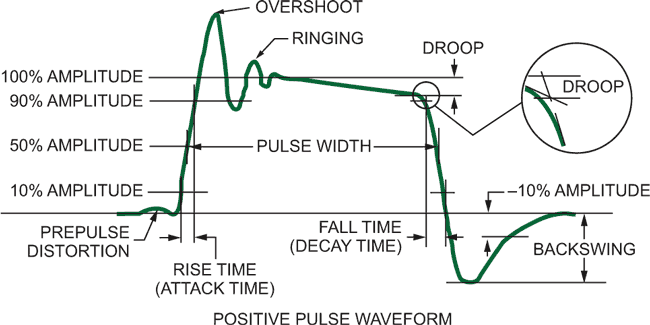

Reflection is a result of impedance mismatch. As a signal travels along a trace, the instantaneous impedance changes at each interface. Part of the signal will reflect back, and part will continue down the line. Reflection can produce overshoot, undershoot, ringing, and nonmonotonic clock edges at the receiver.

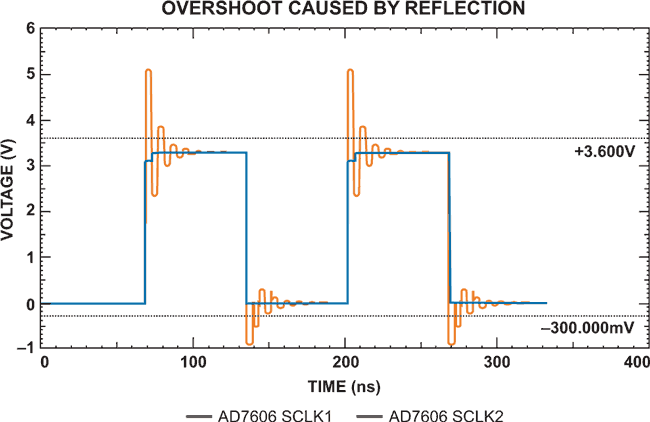

Overshoot and undershoot can damage the input protection circuitry or shorten the IC’s life span. Figure 6 shows the absolute maximum ratings of the AD7606. The digital input voltage should be between –0.3 V and VDRIVE + 0.3 V. In addition, ringing above VIL maximum or below VIH minimum may cause logic errors.

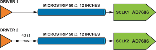

Figure 8 shows one driver connected to SCLK1 through a 12 inch microstrip line, and a second driver connected to SCLK2 through a 43 Ω resistor in series with the microstrip.
| Figure 8. | Drive AD7606 SCLK. |
Figure 9 shows a large overshoot on SCLK1 that violates the –0.3 V to +3.6 V absolute maximum rating. The series resistor reduces the slew rate on SCLK2, keeping the signal within the specifications.

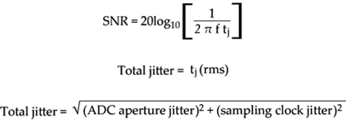

Aperture or sampling clock jitter sets the limit for SNR, especially for high-frequency input signals. System jitter comes from two sources: aperture jitter from the on-chip track-and-hold circuitry (internal jitter) and jitter on the sampling clock (external jitter). Aperture jitter is the conversion-to-conversion variation in the sampling time, and is a function of the ADC. The sampling clock jitter is usually the dominant source of error, but both sources cause varying analog input sampling times, as shown in Figure 10. Their effects are indistinguishable.
The total jitter produces an error voltage, with overall SNR of the ADC limited by
where, f is the analog input frequency and tJ is the total clock jitter.
For example, with a 10 kHz analog input and 1 ns total jitter, the SNR is limited to 84 dB.
