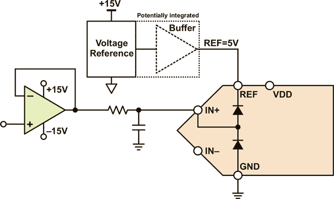

Let’s consider the scenario below in Figure 1.

This circuit is representative of what we see in the AD798X (e.g. AD7980) family of PulSAR ADCs. There are protection diodes between the input, the reference and ground. These diodes are capable of handling high currents up to 130 mA in the case of the AD798X family but only for a few milliseconds, not for longer periods or repeated overvoltage. On some products like the AD768X/9X (e.g. AD7685, AD7691) family of parts the protection diodes are to the VDD pin instead of REF. On these parts the VDD voltage is always greater than or equal to REF. Generally this works better as VDD is a stiffer rail for clamping and is not as sensitive to disturbance.
In Figure 1 if the amplifier was to rail towards the +15 V rail then the protection diode to REF will turn on and the amplifier will try to drag the REF node up. If the REF node is not driven by a strong driver circuit then the voltage at the REF node (and input) will rise above the absolute maximum rated voltage and the ADC may be damaged if the voltage exceeds the breakdown voltage of devices on that process. See Figure 3 below for an example of the ADC driver railing towards +8 V overdriving the reference voltage (5 V). Many precision references have no sink current capability which is a problem in this scenario. Alternatively the reference drive circuit may be strong enough to hold the reference close to its nominal value but will still be disturbed from its precise value.

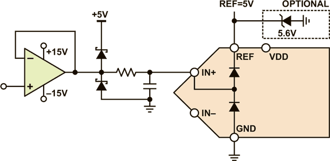

There are a few different approaches or ones used in combination to mitigate this issue. The most common is to use schottky diodes (e.g. BAT54 series) to clamp the output of the amplifier to the range of the ADC. See Figures 2 and 3 for an illustration. It may also be possible to use diodes to clamp the input to the amplifier if it suits the application needs.

In this case the schottky diodes are chosen for their low forward voltage drop such that they turn on before the internal protection diodes in the ADC. The series resistor after the schottky diodes also helps limit the current into the ADC if the internal diodes turn on slightly. For extra protection, if the reference has little/no sink current capability, a zener diode or clamp circuit could be used on the reference node to guarantee the reference voltage cannot be pulled too high. In the above example a 5.6 V zener is used for a 5 V reference.

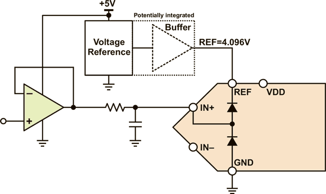

A way of eliminating over voltage issues completely is to use a single supply rail for the amplifier. This means the driving amplifier can never swing below ground or above the max input voltage if the same supply level is used as for the reference voltage (max input voltage), in this example 5 V. It may be possible to use the reference circuit to supply the amplifier directly if it has sufficient output current/ drive strength. Another possibility as shown below in Figure 5 is to use a slightly lower reference value (e.g. 4.096 V when using a 5 V rail) resulting in significantly reduced voltage overdrive capability.
Protecting ADC inputs
Figure 5. Using a lower reference value to reduce voltage overdrive capability.
These approaches solve any issue with overdriving the input but the tradeoff will be limited input swing/range to the ADC because of amplifier headroom/footroom requirements. Typically a rail-to-rail output amplifier can get within 10’s of mVs of the rail but it is also important to consider input headroom requirement, which can be 1 V or more, as this will limit the swing further in a buffer/unity gain configuration. This approach offers the simplest solution in terms of no additional protection components needed but depends on having the correct supply voltage and possibly a rail-to-rail input output (RRIO) amplifier.
The series R in the RC filter between the amplifier and RC can also be used to limit the current seen at the ADC input during an overvoltage condition. However this will be a tradeoff between current limiting and ADC performance. Larger series R will give better input protection but result in greater distortion in the ADC performance. This may be an acceptable tradeoff especially if the input signal bandwidth is low or the ADC is not being run at the full throughput rate as more series R can be tolerated in this case. The size of R acceptable for the application can be determined experimentally.
