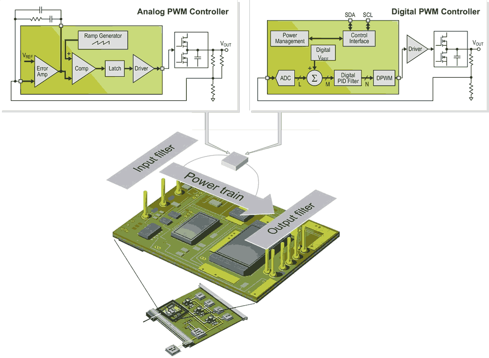

Power supply control
A classic analog power supply control loop is shown in Figure 1. A pulse width modulator (PWM) integrated circuit (IC) is used as the primary control element. The power supply output voltage is sampled by means of a resistive voltage divider and compared with a DC reference voltage by an error amplifier.
| Figure 1. | Block diagrams of analog and digital control systems depicted together with some parts of the power train. |
The error amplifier output signal is used by the PWM to control the “on time” of the power switch.
For loop compensation, which is needed to ensure the proper balance of dynamic response and stability, a fixed resistor and capacitor network is typically used external to the PWM IC.
Two other major sections of the power supply are the input and output filter networks. These sections, composed of inductors, capacitors and resistors, provide several functions. The input filter helps protect the power supply from transients in the supply voltage, provides some energy storage for power supply operation during dynamic load changes, and includes filter networks to allow the power supply to meet its input conducted emissions specifications.
The output filter provides smoothing of the output voltage to ensure that the ripple and noise specifications are achieved and also contains energy storage for servicing dynamic current requirements of the load circuits. It is important to note that the input and output filters and the power devices remain essentially the same with either an analog or a digital control structure.
Figure 1 depicts the structure of a typical digital power supply control system.
The sensing of the output voltage is similar to that in an analog design. Rather than an error amplifier, however, the sensed analog voltage is converted to a binary digital number with an analog to digital converter (ADC). The digital outputs from the analog to digital converter (ADC) are fed to a microcontroller (µC) that provides the processing. On board read-only memory (ROM) program memory is used to store the control algorithms for the µC.
These algorithms allow the µC to perform a series of calculations on the digital outputs from the analog to digital converter (ADC). The results of these calculations are such parameters as the error signal, the desired pulse widths for the drivers, optimized values for delay in the various drive outputs, and also the loop compensation parameters. The external loop compensation components used with the analog system are no longer needed.
All values of parameters such as output voltage, output current and temperature are stored in electrically erasable programmable read-only memory (EEPROM) at manufacturing or via transfer with a communications bus. The EEPROM content is downloaded to the random access memory (RAM) during power-up, and the µC then uses this part of the memory for read and write operations.

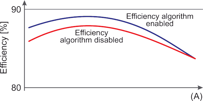

Digital control is considerably more flexible than analog control in its ability to adapt to changes in line and load conditions. It has the ability to change the control parameters as a function of the power supply operating conditions. This is illustrated by the following examples.
In a synchronous buck power supply, the top and bottom metal oxide semiconductor field-effect transistors (MOSFETs) are operated so that both never conduct simultaneously. This is guaranteed by defining a “dead time” period after one of them is turned off and before the other is turned on. With digital control the dead time does not need to be fixed, but can be varied via a digital control loop as a function of operating conditions to optimize the power supply efficiency. This technique is especially valuable at low load as shown in the comparison in Figure 2.
| Figure 2. | A parameter such as “dead time” in a synchronous buck power supply may be optimized over line and load conditions to improve efficiency |

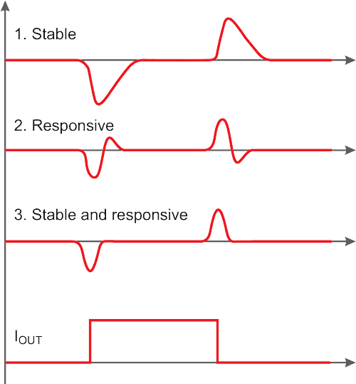

In analog control designs, the feedback loop compensation is a compromise between stability and dynamic response performance. Using digital control techniques, it is possible to construct non-linear, or adaptive, control loops that change the compensation as a function of operating conditions. That is, the power supply displays fast response when it needs to and slower response in other situations.
Figure 3 shows examples of this adaptive behavior. In addition to the enhanced dynamic response, this approach has other benefits to the power system. Fewer output decoupling capacitors are required to ensure a given voltage tolerance, with resulting savings in cost and component space. Nonlinear control can also be used to allow power supply operation in discontinuous mode without the usual disadvantage of poor dynamic performance.
| Figure 3. | Non-linear, or adaptive, control loops can combine the benefits of stability and responsiveness. |

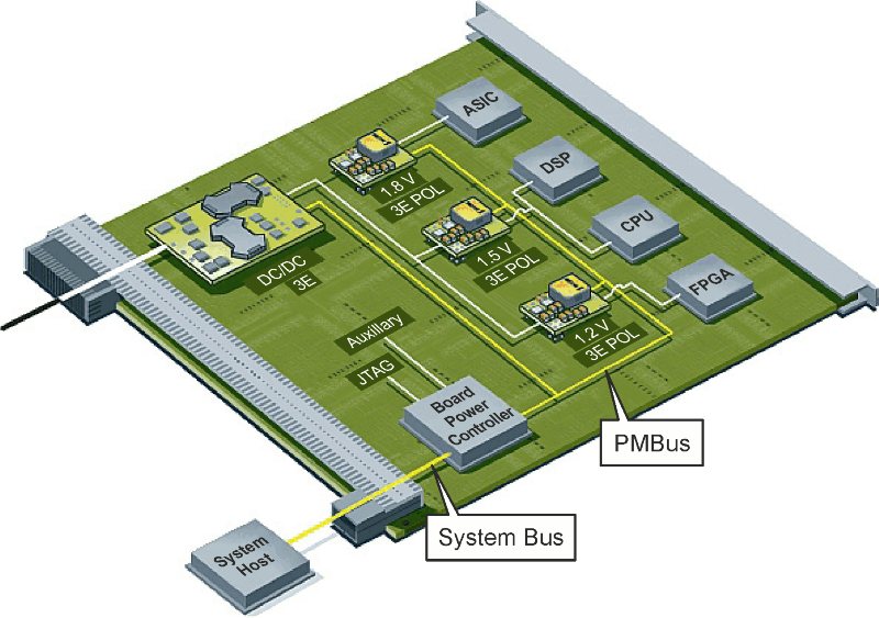

The digital power management system has a basic architecture consisting of power supplies that communicate with a centralized power system host control via a digital communications bus as described in Figure 4.
| Figure 4. | A digital power management system consisting of power supplies (slaves) connected to a controller (master) via a communications bus depicted by the yellow lines. |
The power supplies are DC/DC converters or point of load (POL) regulators. The control device can take many forms, including:
- An IC dedicated to power system control
- A general purpose microcontroller
- A laptop computer with a graphical user interface (GUI)
- ATE during the power supply or system testing process.
The host device has a control domain consisting of a single system board, and for some larger scale systems, this host will in turn interact with higher system level controllers.

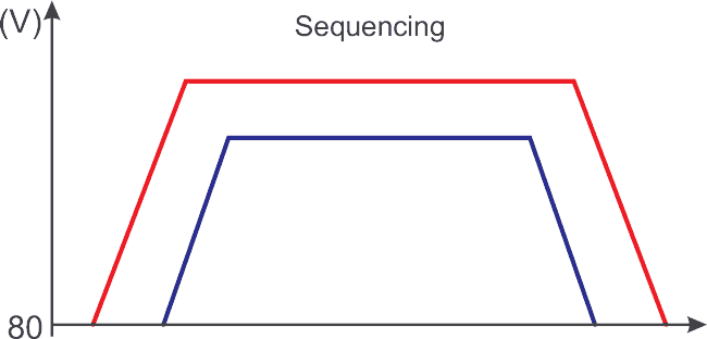

System power control is becoming more complex as the number of voltage levels on a typical board increase. This greatly increases the complexity of the voltage sequencing.
Sequencing order, ramp times and delays need to be controlled for both normal start-up and shutdown operation as well as for some fault conditions. All this is straightforward with digital management without resorting to installing analog control and timing components or even using a soldering iron (Figure 5).
| Figure 5. | The sequencing order for start-up and shut-down of multiple power supplies can be controlled using digital power management. |

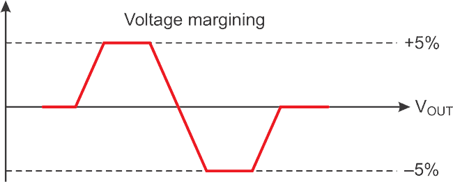

Voltage margining is another example of using digital management for power supply control. This is used during the final stages of production to verify the robustness of the unit. Voltages are varied by perhaps ±5 percent in different combinations (Figure 6). Using the digital communications bus, this can be accomplished in less than a second without any additional hardware or interconnections.
| Figure 6. | Digital power management can be used for voltage margining of the output from the power supply (corner testing). |

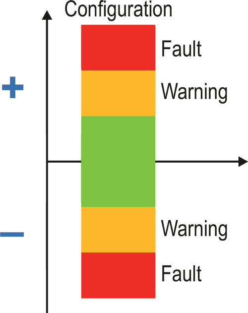

A common requirement that falls into the configuration category is programming thresholds for fault detectors. Using a digital bus results in extreme flexibility:
- Temperature protection can be set, and operation can be configured digitally for either latching or automatic restart.
- Over current protection can be set, and latching or automatic recovery modes can be programmed.
- An over voltage protection trip point for a specific output voltage trimming and latching is easily programmed, as are automatic recovery modes.
Monitoring consists of measurement of such parameters as input and output voltages and currents, operating frequency, and temperatures interior to the power supplies. Most OEMs will find this capability to be of the greatest use during the design and evaluation phases of a new system.
Digital monitoring allows for all of these measurements to be made via a laptop computer and GUI rather than with thermocouples, soldering irons and component replacements. Gaining parametric information at this stage allows for optimization of the power system and for the selection of the most cost-effective power supplies.
Designers of high-end and high-availability systems may want to incorporate these kinds of capabilities in the final product, so that parametric data can be collected in the system operating environment. Examples of capabilities with this approach are:
- Efficiency may be monitored and degradation noted prior to actual failure so that part replacements can be made without affecting system availability.
- System fan speed can be controlled as a function of actual temperatures inside power supplies.
- A complete field population of systems can be queried to find the locations of power supplies with a particular serial number, in order to replace a suspect batch of power supplies before the advent of field failures.
Most users will not need to use this degree of sophistication in their designs. An intermediate approach is to use an interrupt-driven design.
| Figure 7. | Limits for both warning and fault conditions can be programmed for parameters such as temperature, output voltage and output current. |
Here, the host controller does not do routine monitoring of parametric data, but is only notified by a power supply when it is experiencing a problem (Figure 7). The host can then take the required action as a function of the power supply fault mode.
