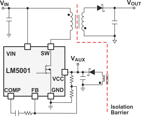

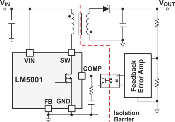

Another popular topology using wide VIN boost power management ICs is the flyback regulator, which can be either isolated or non-isolated. A non-isolated flyback regulator (Figure 3) is an alternative solution to SEPIC to realize both step-up and step-down conversion. An isolated flyback regulator (Figure 4) is an attractive solution to provide galvanic isolation, enhanced safety, and improved noise immunity. Besides the simplicity of the flyback regulator, another notable advantage is that no additional magnetic components are required to add multiple outputs.
How to design boost, SEPIC and flyback regulators with wide VIN boost power management ICs How to design boost, SEPIC and flyback regulators with wide VIN boost power management ICs
а) b)
Figure 4. Isolated flyback.
In isolated flyback regulators, either an optocoupler or a tertiary winding is commonly used to implement output voltage feedback. In an isolated flyback with optocoupler, an adjustable shunt regulator such as the LM431, or a standard error amplifier plus a voltage reference, can be employed for feedback from secondary to primary. The design with an optocoupler (Figure 4a) provides tight load regulation for VOUT on secondary side, while the design with a tertiary winding (Figure 4b) features simplicity without additional optocoupler and error amplifier. The output of the tertiary winding (VAUX) also can serve as the bias supply to the regulator to reduce its internal power loss at high VIN.
