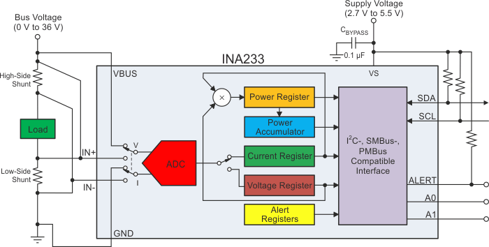

A better way to monitor power is to use a digital current monitor to handle the mathematical processing, freeing up the processor to deal with other system tasks, and alerting the processor if higher level system actions need to occur. Texas Instruments provides a wide range of digital power and current monitors to address this problem. One such power, current and voltage monitor is the INA233. The INA233 enables the monitoring of voltage, current, power, and energy via an I2C, SMBus, PMBus compatible interface. A typical application and block diagram of the INA233 is shown in Figure 1.

Figure 1. INA233 Typical Application Circuit.

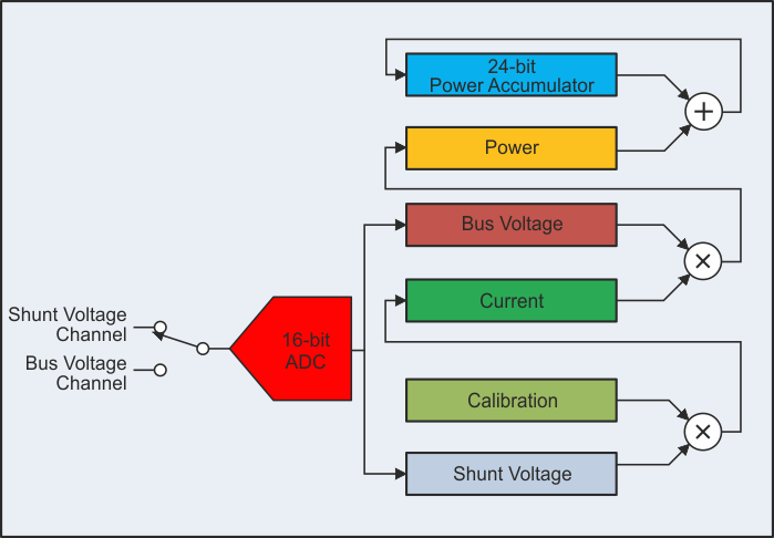

A simplified block diagram of the power conversion engine is shown in Figure 2. Power is internally calculated from the shunt and bus voltage measurements in an interleaved fashion to minimize time alignment errors in the power calculation.

Figure 2. INA233 Power Conversion Engine.
The internal calculations for power are done in the background independent of ADC conversion rates or digital bus communications. The device also features an ALERT pin that will notify the host processor if the current, power, or bus voltage is out of the expected range of operation. In the INA233, fault events are handled independently, such that multiple simultaneous fault conditions can be reported by reading internal status registers when the ALERT pin asserts. The internal processing and alert capabilities of the INA233 free the host processor to manage other tasks while the device takes care of continually monitoring the system. The host processor is notified via the ALERT pin only when additional attention is needed.

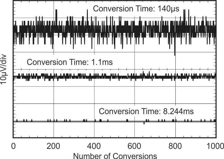

The ADC conversion times for both shunt and bus voltage measurements are programmable from 140 μs to 8.244 ms. Longer conversion times are useful to decrease noise susceptibility and to achieve increased stability in device measurements. The effects of increased ADC conversion times measurements results is shown in Figure 3.

Figure 3. Noise vs. ADC Conversion Time.
In addition to programmable ADC conversion times, the device can average up to 1024 conversion cycles and update the internal power, current, and voltage registers once the averaging is finished. Programmable conversion times along with averaging windows allow the device telemetry update rate to be adjusted to meet system timing needs.
