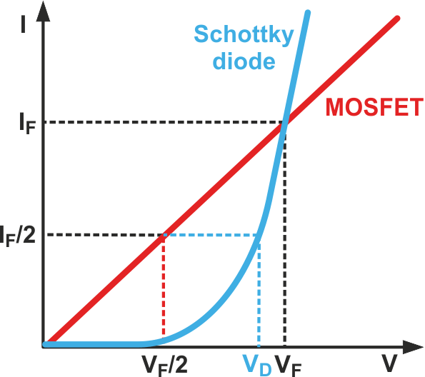

A synchronous recitifier MOSFET usually has lower forward voltage drop than a Schottky diode, which leads to lower conduction loss. Hence, synchronous regulators can obtain higher efficiency, especially in low-voltage and high-current applications. A MOSFET has a positive temperature coefficient of on-resistance, which means the forward voltage drop increases as the temperature goes up. This characteristic causes current to flow equally through multiple devices when they are connected in parallel. As such, a MOSFET is more suitable for parallel operation in high-current applications than Schottky diodes which have a negative temperature coefficient.
Furthermore, paralleling of MOSFETs is much more effective than paralleling of Schottky diodes when it comes to conduction loss reduction. Figure 9 compares parallel operation characteristics between a MOSFET and Schottky diode. Reducing the MOSFET current to half its original value also reduces the MOSFET conduction loss to half its original value due to linear I-V characteristic. In contrast, reducing the Schottky diode current to half its original value also reduces the Schottky loss. However, the new Schottky loss is higher than half its original value because of exponential I-V characteristic.

Figure 9. Characteristic comparison between
