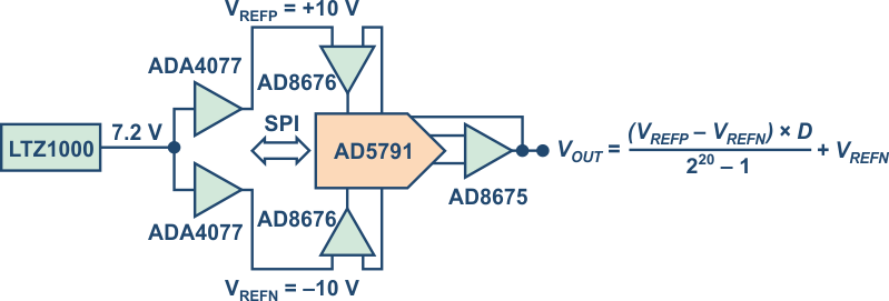

Today in our Combo Circuit from the Lab series, we are showcasing an ultrahigh precision programmable voltage source using ADI/LTC products together. The AD5791 with the LTZ1000, ADA4077, and AD8675/AD8676 can be used to provide a programmable voltage source that achieves 1 ppm resolution with 1 ppm INL and better than 1 ppm FSR long-term drift (Figure 1). This powerful combination helps provide radiologists with the superior image clarity, resolution, and contrast they need, enabling them to see smaller anatomical structures. Just think of what this means when applied to an MRI (magnetic resonance imaging). Enhanced imagery of organs and soft tissues will allow medical professionals to more accurately detect heart problems, tumors, cysts, and abnormalities in various parts of the body. This is just one of many applications for this programmable voltage source.
High Precision Voltage Source
Figure 1. Programmable voltage source.

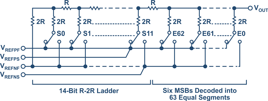

AD5791
The AD5791 is a 20-bit, unbuffered voltage output digital to analog converter with 1 ppm relative accuracy (1 LSB INL) and 1 LSB DNL (guaranteed monotonic). It has an impressive 0.05 ppm/ °C temperature drift, 0.1 ppm p-p noise, and better than 1 ppm long-term stability. The AD5791 contains a precision R-2R architecture that exploits state-of-the-art, thin film resistor matching techniques (Figure 2). It operates from a bipolar supply up to 33 V, and it can be driven by a positive reference in the range of 5 V to VDD –2.5 V and a negative reference in the range of VSS +2.5 V to 0 V. The AD5791 uses a versatile 3-wire serial interface that operates at clock rates up to 35 MHz and that is compatible with standard SPI, QSPI™, MICROWIRE™, and DSP interface standards. The AD5791 is offered in a 20-lead TSSOP package.
Figure 2. AD5791 DAC ladder structure.

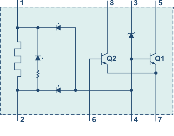

LTZ1000
The LTZ1000 is an ultrastable temperature controllable reference. It provides 7.2 V output with an impressive 1.2 µV p-p of noise, long-term stability of 2 µV/√kHr, and temperature drifts of 0.05 ppm/ °C. The part contains a buried Zener reference, a heater resistor for temperature stabilization, and a temperature sensing transistor (Figure 3). External components are used to set operating currents and to temperature stabilize the reference – this allows for maximum flexibility and the best long-term stability and noise.
Figure 3. LTZ1000 simplified schematic.

Some Circuit Considerations
Noise
Low frequency noise must be kept to a minimum to avoid impact on the dc performance of the circuit. In the 0.1 Hz to 10 Hz bandwidth, the AD5791 generates about 0.6 μV p-p noise, each ADA4077 will generate 0.25 μV p-p noise, the AD8675 will generate 0.1 μV p-p noise, and the LTZ1000 generates 1.2 µV p-p noise. Resistor values were chosen to ensure that their Johnson noise will not significantly add to the total noise level.
AD5791 Reference Buffer Configuration
The reference buffers used to drive the REFP and REFN pins of the AD5791 must be configured in unity gain. Any extra currents flowing through a gain setting resistor into the reference sense pins will degrade the accuracy of the DAC.
