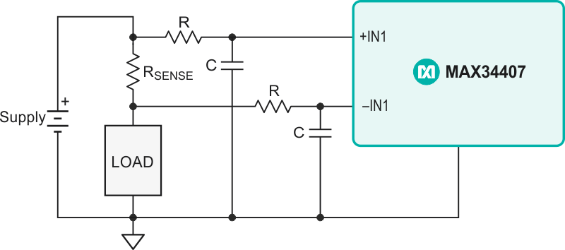

MAX34407 operates by taking high-side measurements, making it prone to common-mode noise. Additional filtering may be required if the system exhibits excessive common-mode noise. RC filters are placed in series with the current-sense input to filter the unwanted noise. Figure 8 demonstrates a common-mode filter configuration using two identical RC filters on each current-sense line. This effectively forms a low pass filter for common-mode signals. Since filter resistors are placed in series with the current-sense path, these resistors must be well matched to prevent offset in the power measurement. For this reason, filter resistors should be chosen to have 1% tolerance or less. In addition, the series filter resistor must be much less than the input impedance of the power accumulator to avoid loading effects. The poles of the filters are chosen to be far below the Nyquist sampling frequency of the accumulator. Below is the equation used to determine the pole of the common-mode filter:

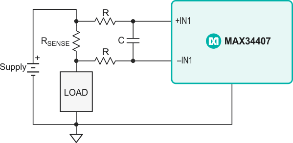

The input current of power supplies is quite noisy due to the internal switching of the power supply topology. This is presented as differential-mode noise to the power accumulator through the high-side current-sense resistor. Differential-mode noise can be attenuated by using a differential-mode filter, as shown in Figure 9. As previously discussed for the common-mode filter, the series resistors must be well matched and their resistances must be much larger than the input impedance of the power accumulator. The pole for the differential-mode filter is also selected to be less than the Nyquist frequency of the power accumulator. The two series resistors and capacitor produce a pole for the differential signal between the MAX34407 inputs (i.e. +IN1/-IN1). Below is the equation used to determine the pole of the differential-mode filter:
