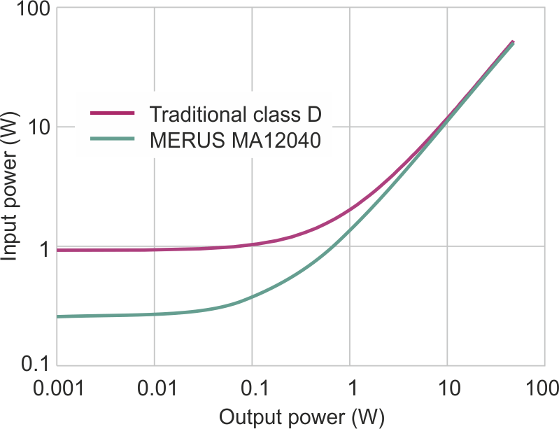

The MERUS™ MA12040 multilevel amplifier as an example, consumes only 250 mW in idle, as seen in Figure 9, which is a power consumption plot. Notice that the near idle power consumption is relatively flat and significantly lower than a conventional class D amplifier all the way up to 2 W output power per channel. Since the overall power consumption is determined by the average power loss and as this is greatly dominated by idle loss when reproducing common audio signals, compared to most conventional class D amplifiers, the multilevel amplifiers demonstrate an overall power efficiency improvement factor of four or higher.
Power consumption of the MERUS<SUP><FONT SIZE=-1>TM</FONT></SUP> MA12040 amplifier.
Figure 9. Power consumption of the MERUS™ MA12040 amplifier.
The importance of improved power consumption is further emphasized when efficiency is considered in Figure 10. For both Figure 9 and Figure 10, the MERUS™ MA12040 amplifier has a maximum output power of 40 W into a 4 Ω load; in both cases, the amplifier runs on an 18 V power rail.

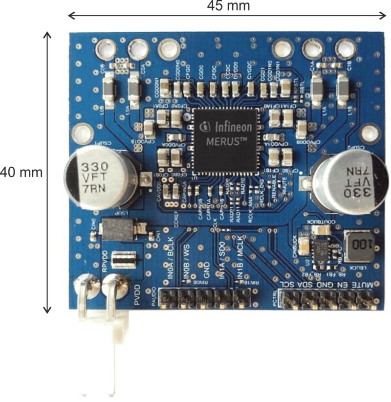

Infineon developed a reference design (Figure 12) as a small-sized circuit board used to demonstrate MERUS™ multilevel amplifier devices for ultra-compact and low-power consumer applications. The solution measures 40 mm × 45 mm and yet still achieves output power up to 80 W per channel. Only a small EMI filter is used with an SMD-sized (1210) ferrite bead and an SMD-sized (0402) 1.0 nF capacitor placed at each half-bridge output of the amplifier.
The Infineon reference design with MERUS<SUP><FONT SIZE=-1>TM</FONT></SUP> multilevel amplifier.
Figure 12. The Infineon reference design with MERUS™ multilevel amplifier.
With no need for significant filtering to combat unwanted interference, multilevel amplifiers can drive speakers directly, often without the use of LC and RC filters, even in higher-powered applications, which reduces application costs. If the audio product designer still wishes to use LC filters, filters can be smaller than those used for traditional class D amplifiers.
