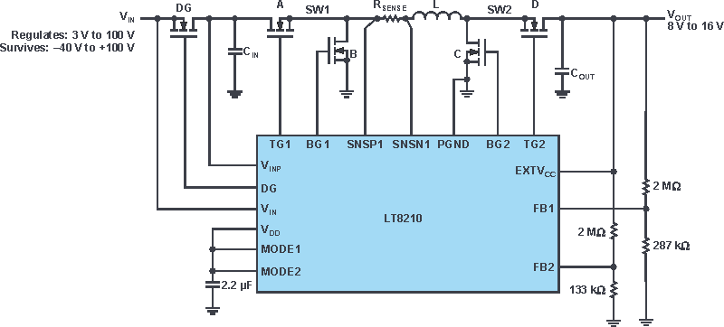

Figure 1 shows a simplified schematic of an LT8210 configured for Pass-Thru operation with the output regulated to be between 8 V and 16 V. The top and bottom voltages of the Pass-Thru window are set by the FB2 and FB1 resistor dividers, respectively.
LT8210 8 V to 16 V Pass-Thru regulator circuit.
Figure 1. LT8210 8 V to 16 V Pass-Thru regulator circuit.

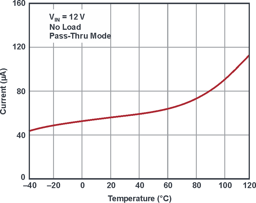

Figure 2 shows the input/output transfer characteristic of this circuit. When the input voltage is above the Pass-Thru window, the LT8210 steps it down to a regulated 16 V output (Figure 3). If the input voltage drops below the window, the LT8210 boosts to maintain the output at 8 V (Figure 4). When the input voltage is within the Pass-Thru window, the top switches, A and D, turn on continuously, allowing the output to track the input and the part to enter a low power state with typical quiescent currents on the VIN and VINP pins of 4 µA and 18 µA, respectively(Figure 5). In this non-switching state, there are neither EMI nor switching losses, making efficiencies greater than 99.9% achievable (Figure 6).

The LT8210 features ultralow quiescent current in the Pass-Thru region.
Figure 5. The LT8210 features ultralow quiescent current in the
Pass-Thru region.
