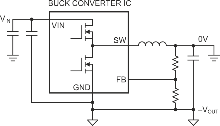

Applications that require power supplies with negative output voltages include test and measurement, aerospace and defense, automotive, and medical. One common approach to creating a negative power rail is to use a conventional buck converter but operate it as an inverting buck-boost converter (References 1-3). The buck converter integrated circuit (IC) ground pins connect to the negative output voltage node (–VOUT) and the inductor output connects to system ground (0V). Figure 1 is an example configuration. The resistor divider from the output to the feedback pin sets the output voltage.
Operating a buck converter as an inverting buck-boost converter generates a negative output voltage.
Figure 1. Operating a buck converter as an inverting buck-boost converter generates

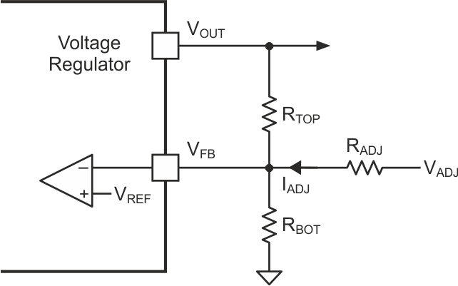

Next, let’s examine dynamic voltage adjustment. For a conventional buck or boost converter, References [6, 7, and 8] demonstrate several methods to adjust the output voltage. One popular method uses a resistor connected between the FB pin and an adjustable voltage source (VADJ), as shown in Figure 2. The voltage at VADJ is adjusted up or down to dynamically adjust the converter’s output voltage. Current will flow through resistor RADJ into the FB node when VADJ is higher than the FB node voltage (which equals the reference voltage, VREF). This results in the output voltage decreasing.
You can dynamically adjust a converter's output voltage by sourcing/sinking current into the FB node.
Figure 2. You can dynamically adjust a converter’s output voltage by sourcing/
Conversely, if the VADJ voltage is lower than the FB node voltage, current will flow in the opposite direction across resistor RADJ and the output voltage will increase.
One way to think about it is that the sourcing (or sinking) current into the FB node makes it appear like the top (or bottom) resistance value has decreased. The resistor’s RADJ acts like a virtual resistor in parallel with the top or bottom resistor.

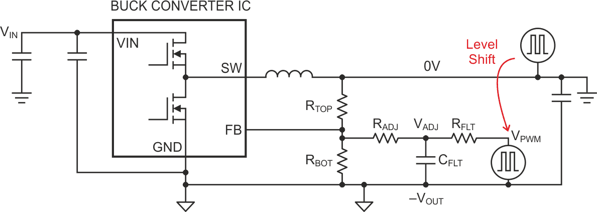

One simple approach to generating VADJ is to provide a pulse-width modulation (PWM) signal that passes through a resistor-capacitor low-pass filter. A microcontroller or other digital chip can output the PWM signal. Controlling the PWM signal’s duty ratio will change VADJ. Using this approach to dynamically adjust the negative output voltage of an inverting buck-boost converter can be a difficult task because the buck converter IC’s local ground is riding on the negative output voltage (–VOUT) instead of the system ground (0V). Level-shifting circuits will likely be necessary, like the interfacing of I/O pins that I mentioned earlier (Figure 3).
Using a ground referenced PWM signal to generate VADJ requires a level-shifting circuit.
Figure 3. Using a ground referenced PWM signal to generate VADJ requires a level-shifting circuit.

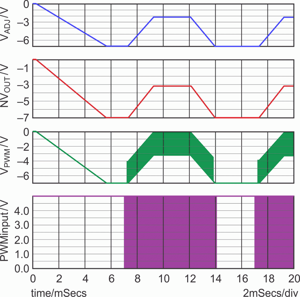

The simulation results in Figure 5 show this approach’s ability to adjust a negative output voltage, with a buck converter operating as an inverting buck-boost converter. During the first 6 milliseconds (ms), the negative output voltage (shown in red and labeled “NVOUT”) starts softly to –7 V. The blue line shows VADJ, which tracks the negative output voltage during startup. The PWM circuit is enabled at 7 ms (the PWM input waveform is shown in purple) and generates the level-shifted PWM (VPWM). VADJ (shown in blue) increases, and the converter output voltage increases in response. The converter reaches the new steady-state operating point (near –2 V) after about 2 ms of transition time. Adjusting the PWM signal lowers the output voltage later in the simulation, with smooth, effective results.
Simulation shows how a level-shifting circuit can be used to dynamically adjust a negative output voltage.
Figure 5. Simulation shows how a level-shifting circuit can be used to dynamically
