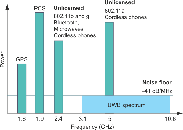

Parts of the frequency range allocated for UWB are already used by existing communication systems. For example, as shown in Figure 1, both 802.11ac - a high-throughput WLAN communication protocol - and UWB are allowed to use the frequency band around 5 GHz.
Diagram of the UWB working below the
Figure 1. Diagram of the UWB working below the "noise floor."
UWB attempts to more efficiently utilize the scarce spectrum resources.
How can the UWB technology use the same spectrum as existing wireless systems without causing interference? This is achieved by restricting the power spectral density of the electromagnetic signal emitted by a UWB transmitter.

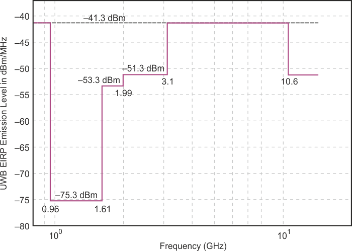

According to the FCC (the U.S. frequency regulator), the power spectral density of an indoor UWB transmitter should be below -41.3 dBm/MHz between 3.1 and 10.6 GHz. This limits the interference caused by a UWB device.
Figure 2 shows the spectral mask mandated by the FCC for an indoor UWB transmitter.
The spectral mask for an indoor UWB transmitter.
Figure 2. The spectral mask for an indoor UWB transmitter.

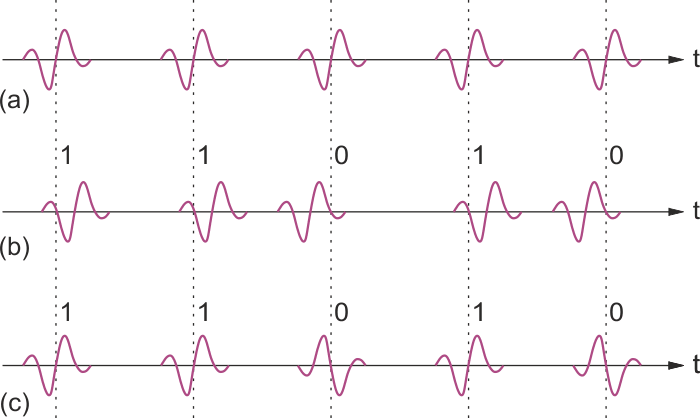

These pulses can be modulated in different ways to convey information. Figure 4 below shows how pulse position modulation and bi-phase modulation change an unmodulated sequence.
Pulse position (b) and bi-phase modulations (c) change an unmodulated sequence (a).
Figure 4. Pulse position (b) and bi-phase modulations (c) change an unmodulated
sequence (a).

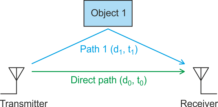

UWB signals exhibit more robustness to the multipath effect than conventional wireless technologies. Assume that in addition to a direct path for the electromagnetic wave propagation from the transmitter to the receiver, there is another path caused by the reflections from an object (Fig. 6).
Depiction of a multipath effect
Figure 6. Depiction of a multipath effect
The time (t) it takes for the transmitted signal to travel the total distance (d) of a given path can be obtained by the following equation:
d = c × t,

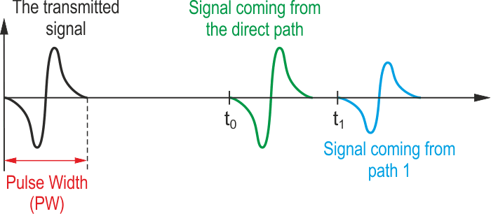

where c denotes the speed of the electromagnetic wave that is approximately 3×108 m/s. Hence, for every pulse that we transmit, two pulses appear at the receiver input. This is illustrated in Figure 7 in which the transmitted and the received pulses are shown in one diagram.
For every pulse transmitted, two pulses appear at the receiver input.
Figure 7. For every pulse transmitted, two pulses appear at the receiver input.
In Figure 7, the two received pulses are easily recognizable because they do not overlap with each other. However, this is not the case in general. Examining the above figure, we can see that the pulses will not interfere - only if the delay difference between the two paths (t1-t0) is larger than the pulse width (PW).
Since UWB pulses have a very short duration, the pulses coming from the different paths are more likely to not interfere with our desired pulse. Hence, we can easily extract the desired signal from those originating from unwanted reflections. This gives a UWB system more immunity to the multipath effect. Alternatively, the energy can be summed together by a rake receiver.
