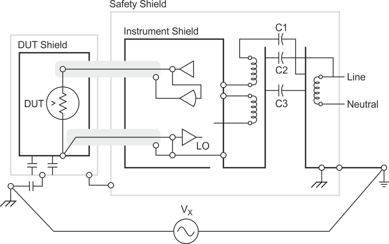

The safety ground shield should never be used as the electrostatic shield. Even well-designed instrumentation generates currents that travel down the safety ground in the line cord. Current from the power supply Y capacitors and higher frequency currents from a switching power supply can generate noise voltages on the instrument chassis with respect to external safety ground as the current flows through the inductance of the power cord. The resulting noise voltage appears as a common mode voltage from the safety ground to the instrument chassis. This voltage is troublesome because instrumentation measurement common is not completely isolated from the instrument chassis (earth grounded). Every instrument generates some DC and AC leakage current across the instrument mains isolation barrier, and a finite capacitance from instrument common to the instrument safety ground. This capacitance is what facilitates the flow of AC current. We do not want these currents to flow through any part of the measurement pathway (see Figure 4). These currents create voltage drops in the measurement leads, as well as voltages across other impedances in the measurement circuit.
An illustration of the power system components that generate common mode current, as well as the isolation capacitances that support AC currents generated externally.
Figure 4. An illustration of the power system components that generate common mode current, as well as the isolation

In the section titled “Safety Grounding,” I mentioned that the instrument(s) themselves are responsible for some of the current that generates the common mode voltage, VX (see Figure 4). These common mode currents are a direct result of the magnitude of the voltages on the primary and secondary windings of the power transformer acting on the unshielded capacitance across the transformer.
Figure 4 illustrates a typical instrument power transformer designed with primary and secondary shields. The shields within a power transformer perform the same function as the instrument shields already discussed. In the case of the instrument shield, when a portion of the measurement remains unshielded, external field lines can inject current into the measurement. The same is true with the power transformer, except due to the proximity of the primary to the secondary windings, as well as the magnitude of the voltages, the currents could be much higher if the transformer shields were absent. The capacitor C1 represents the unshielded capacitance from the secondary winding to the primary shield. This is the portion of the primary that remained unshielded. Likewise, the capacitor C2 represents the unshielded capacitance from the primary winding to the secondary shield. The total common mode current is the sum of the currents through each of these capacitors. The common mode current will increase as the primary and secondary transformer voltages increase or when the frequency of the power supply operation increases. The unshielded capacitance offers increasingly lower impedance to higher frequency edges, increasing the magnitude of the common-mode current.
Common-mode current originating on the primary flows through the capacitor C2 into the secondary circuits, into the chassis through the measurement leads, and eventually returns to the primary ground that generated it. Common-mode current originating on the secondary flows through the capacitor C1 into the primary circuit, into the chassis at the power-entry module, then through the measurement leads, and eventually returns to the secondary ground that generated it. The net common-mode current causes a voltage drop in the instrument power cord inductance, as well as a voltage drop in the ground connection between the DUT and the instrument. For this reason, it is best to use the chassis connection provided by the instrumentation whenever possible to avoid introducing a new safety ground to the system. The unshielded capacitance and, to a lesser degree, the DC resistance across the transformer can couple noise currents from other sources that generate differences in safety grounds throughout the building.

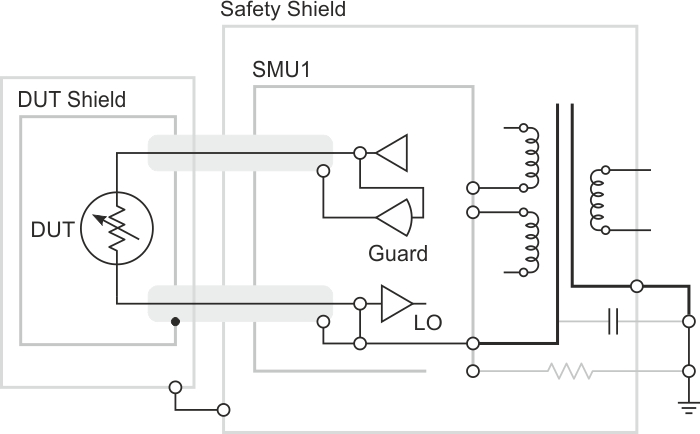

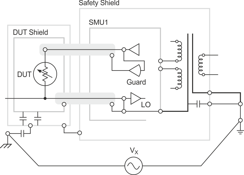

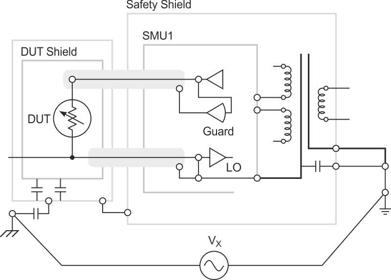

In the example shown in Figure 5a, if the measurement LO terminal were to be grounded to earth at the DUT LO terminal, either directly or through a capacitance, ground currents would flow in the measurement leads, and remote sensing would have to be used to eliminate the error voltage generated by the E‑field between the two safety grounds. In Figure 5b, if the shield surrounding the DUT were connected to earth, current would not flow through the measurement LO connection. In this case, the capacitance from the DUT to its surrounding shield should be minimized. In Figure 5c, the shield is connected to earth at the instrument through a current limiting resistor. In this case, the potential between safety earth grounds depicted by VX does not force any current because only one safety earth ground has been introduced.
With a single SMU, grounding the DUT, either directly or through a capacitance, can channel ground current into the measurement LO lead.
Figure 5a. With a single SMU, grounding the DUT, either directly or through a capacitance, can channel
In this single SMU application, grounding LO at the DUT, either directly or through a capacitance, leads to no error currents in the measurement LO lead.
Figure 5b. In this single SMU application, grounding LO at the DUT, either directly or through a capacitance,
With a single SMU, grounding the shield with a resistor, at the instrument leads to no error current in the measurement LO lead .
Figure 5c. With a single SMU, grounding the shield with a resistor, at the instrument leads to no error
In all of these examples, the guard should be brought as close to the DUT as possible and dropped only after it is within the DUT shield.

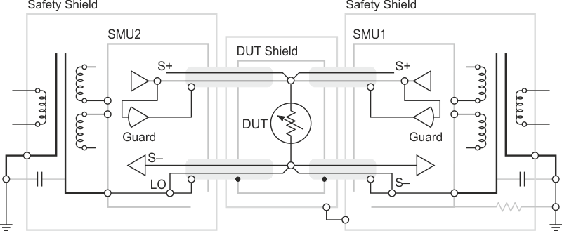

Figure 5d introduces a second instrument into the test system. In this case, preventing all ground currents from entering into the measurement is difficult because there are two different safety ground connections. So, the resulting current can be reduced by connecting LO to safety earth with a high resistance at only a single point, by connecting both shields to the DUT shield, as shown in Figure 5d. In this case, the bulk of the current will flow through both power transformers and through the shield system. Some current will flow through the measurement leads, so remote sensing will also be necessary.
With two SMUs, the remote sense lines compensate for the current flowing in the measurement leads generated from the use of two different grounds.
Figure 5d With two SMUs, the remote sense lines compensate for the current flowing in the measurement leads generated
