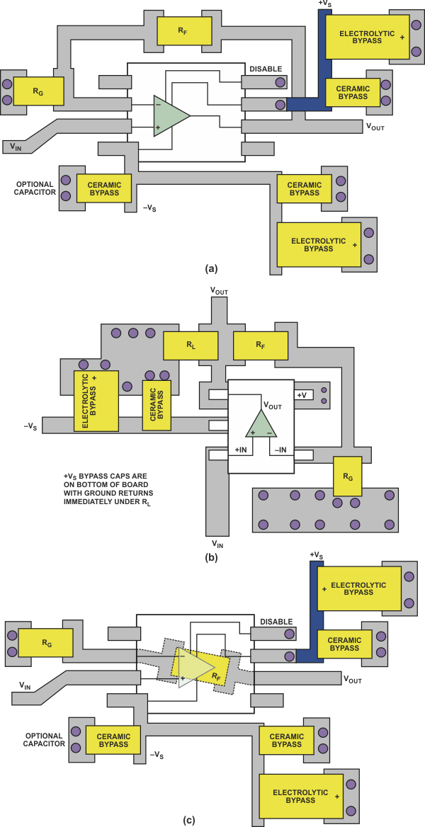

Op amps are typically offered in a variety of packages. The package chosen can affect an amplifier’s high-frequency performance. The main influences are parasitics (mentioned earlier) and signal routing. Here we will focus on routing inputs, outputs, and power to the amplifier.
Figure 9 illustrates the layout differences between an op amp in an SOIC package (a) and one in an SOT-23 package (b). Each package type presents its own set of challenges. Focusing on (a), close examination of the feedback path suggests that there are multiple options for routing the feedback. Keeping trace lengths short is paramount. Parasitic inductance in the feedback can cause ringing and overshoot. In Figures 9(a) and 9(b), the feedback path is routed around the amplifier. Figure 9(c) shows an alternative approach – routing the feedback path under the SOIC package – which minimizes the feedback path length. Each option has subtle differences. The first option can lead to excess trace length, with increased series inductance. The second option uses vias, which can introduce parasitic capacitance and inductance. The influence and implications of these parasitics must be taken into consideration when laying out the board. The SOT-23 layout is almost ideal: minimal feedback trace length and use of vias; the load and bypass capacitors are returned with short paths to the same ground connection; and the positive rail capacitors, not shown in Figure 9(b), are located directly under the negative rail capacitors on the bottom of the board.
Layout differences for an op-amp circuit. (a) SOIC package, (b) SOT-23, and (c) SOIC with RF underneath board.
Figure 9. Layout differences for an op-amp circuit. (a) SOIC package, (b) SOT-23,

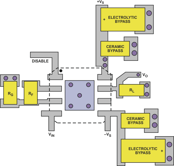

The low-distortion pinout permits a close connection between the output (the dedicated feedback pin) and the inverting input, as shown in Figure 11. This greatly simplifies and streamlines the layout.
PCB layout for AD8045 low-distortion op amp.
Figure 11. PCB layout for AD8045 low-distortion op amp.

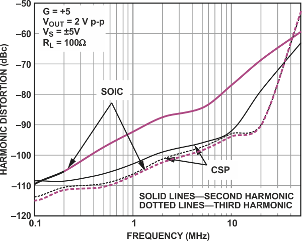

Another benefit is decreased second harmonic distortion. One cause of second-harmonic distortion in conventional op-amp pin configurations is the coupling between the noninverting input and the negative supply pin. The low-distortion pinout for the LFCSP package eliminates this coupling and greatly reduces second-harmonic distortion; in some cases the reduction can be as much as 14 dB. Figure 12 shows the difference in distortion performance between the AD8099 SOIC and the LFCSP package.
AD8099 distortion comparison - the same op amp in SOIC and LFCSP packages.
Figure 12. AD8099 distortion comparison – the same op amp in SOIC and
LFCSP packages.

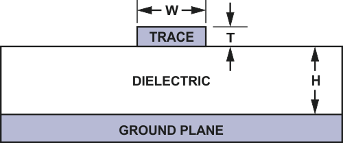

High-frequency (RF) signals are typically run on controlled-impedance lines. That is, the trace maintains a characteristic impedance, such as 50 ohms (typical in RF applications). Two common types of controlled-impedance lines, microstrip and stripline can both yield similar results, but with different implementations.
A microstrip controlled-impedance line, shown in Figure 13, can be run on either side of a board; it uses the ground plane immediately beneath it as a reference plane.
A microstrip transmission line.
Figure 13. A microstrip transmission line.
Equation 6 can be used to calculate the characteristic impedance for an FR4 board.
  (6)
H is the distance in from the ground plane to the signal trace, W is the trace width, T is the trace thickness; all dimensions are in mils (inches × 10-3). εr is the dielectric constant of the PCB material.

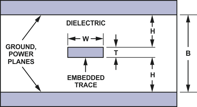

Stripline controlled-impedance lines (see Figure 14) use two layers of ground plane, with signal trace sandwiched between them. This approach uses more traces, requires more board layers, is sensitive to dielectric thickness variations, and costs more – so it is typically used only in demanding applications.
Stripline controlled-impedance line.
Figure 14. Stripline controlled-impedance line.

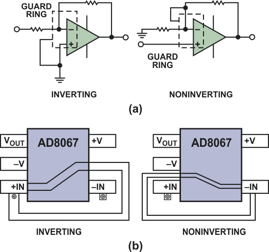

Guard rings, or “guarding,” is another common type of shielding used with op amps; it is used to prevent stray currents from entering sensitive nodes. The principle is straightforward – completely surround the sensitive node with a guard conductor that is kept at, or driven to (at low impedance) the same potential as the sensitive node, and thus sinks stray currents away from the sensitive node. Figure 15(a) shows the guard ring schematics for inverting and noninverting op-amp configurations. Figure 15(b) shows a typical implementation of both guard rings for a SOT-23-5 package.
Guard rings. (a) Inverting and noninverting operation. (b) SOT-23-5 package.
Figure 15. Guard rings. (a) Inverting and noninverting operation. (b) SOT-23-5 package.
