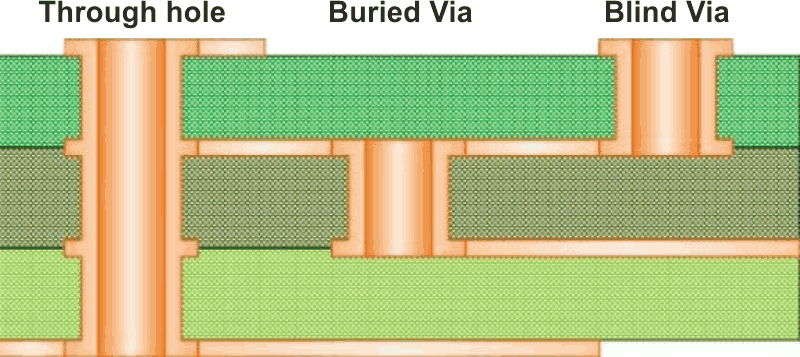

However, one of the most effective ways to propagate heat through the PCB is to use vias. Thermal vias are commonly used in PCBs as a mean to dissipate heat vertically from surface mount components to the PCB inner layers. Vias are simple mechanical drillings made to penetrate the PCB and thereby connect multiple layers in the PCB.
Figure 1 shows the different type of vias typically used in the PCB industry, they also differ in terms of use and costs.
Different use of vias.
Figure 1. Different use of vias.
Through-hole vias are the most used and cheapest to manufacture. There are micro vias called buried vias: which can connect the internal layers without being exposed to outer air, and blind vias: which can connect the internal layers and are exposed on one side of the board. Both buried vias and blind vias provide only a partial connection between the PCB layers and add a degree of complexity to the design which results in a more expensive PCB design.

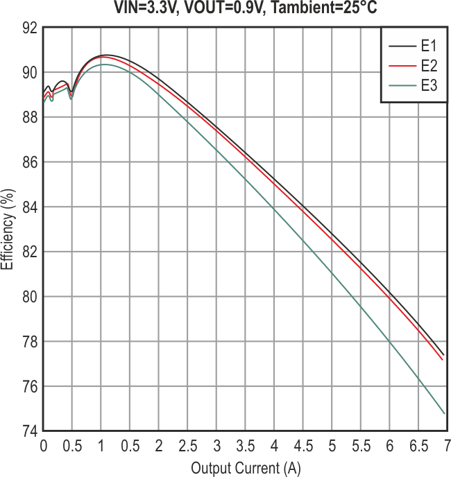

In addition to the reduction of the thermal resistance of the device, the optimization of the layout for thermals also can offer improvements in terms of efficiency. The use of thermal vias allows a better connection of the switching plane to inner layers of the design, by providing a low resistive path and consequently increases the switch node copper area. The fast swinging from the input voltage to ground at high frequency makes the switch node a critical thermal connection.
Table 1 shows the associated efficiency curves to the different layout implementations.
Table 1.  PCB Layout Comparison Table
VIN = 3.3 V, VOUT = 0.9 V E1 E2 E3
Strategy Performance optimized Cost optimized Performance and Cost
Max temperature at 6 A 94.7°C 117°C 96°C
Peak efficiency 90.75% 90.29% 90.66%
The efficiency curves comparison (Figure 8) reflects that better efficiency results can be achieved by increasing copper area at the switching node. Thus, it is important to consider wide connection at the switch node.
Efficiency Comparison Between Layouts.
Figure 8. Efficiency Comparison Between Layouts.
