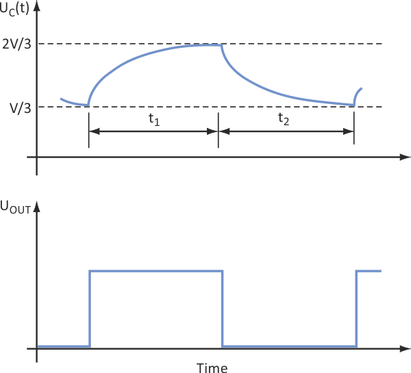

Even with the extra resistor, the timer operates in its usual way. When switch S inside the chip is open, capacitor C is charged through the R1-R2 network (Fig. 2), and the capacitor's voltage rises. When it reaches 2/3 of the power supply, V, the switch closes and capacitor starts discharging. When the voltage drops to the V/3, the switch opens again and the cycle repeats.
The third resistor doesn't affect the circuit's normal charge-discharge cycle.
Figure 2. The third resistor doesn’t affect the circuit’s normal charge-discharge cycle.
The time intervals t1 and t2 are:

where p = R2/R1 and q = R3/R1. For a 50% duty cycle, t1 = t2, so:
  (3)
And frequency is simply:
  (4)
Equation 3 is a relation between p and q. If p is set, then q can be calculated. Note that the term under the log operator at the right side must always be positive. This is fulfilled when both the nominator and denominator have identical signs, and it leads to two intervals for q, one from 0 to 0.5 and the other from 2 to infinity. This said, a simple iterative procedure can be used to calculate q. When that's done, R1, R2, and R3 can be defined.
