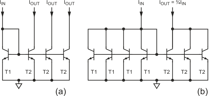

These current mirrors can be made with NPN or PNP transistors. By forming T2 with n transistors connected in parallel, the output current will be n times the input current, as shown in Figure 2a. If T1 consists of m transistors and T2 of n transistors, then the output current will be n/m times the input current, as shown in Figure 2b.
((a) Multistage current mirror, and (b) noninteger-ratio current mirror. The three T2 collectors may be joined to give 3IIN.
Figure 2. ((a) Multistage current mirror, and (b) noninteger-ratio current mirror. The three T2 collectors

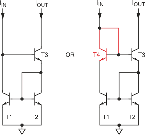

If the effect of Early voltage is important, it can be minimized by using the slightly more complex Wilson current mirror. Both three-transistor and four-transistor versions are shown in Figure 3. The four-transistor version is more accurate and has a wider dynamic range.
Токовое зеркало Вильсона. Транзистор T4 в этой схеме необязателен, но он улучшает точность и динамический диапазон.
Figure 3. Wilson current mirror. T4 is optional but improves accuracy
and dynamic range.

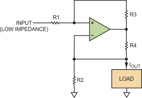

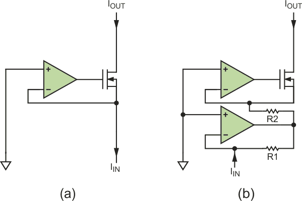

Current mirrors have relatively high, sometimes nonlinear input impedance, so they must be fed by a current from a high-impedance current source (sometimes known as a stiff current source). An op amp is required if the input current must have a low-impedance sink. Figure 6 shows two low ZIN current mirrors.
(a) Inverting low ZIN current mirror, and (b) noninverting low ZIN current mirror.
Figure 6. (a) Inverting low ZIN current mirror, and (b) noninverting low ZIN current mirror.

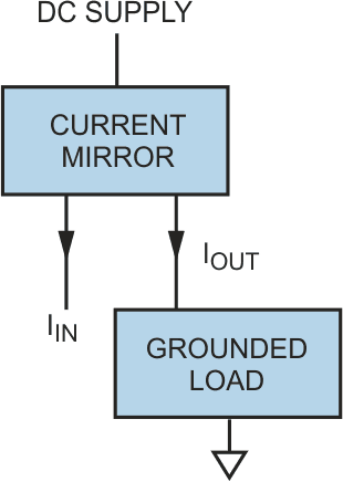

With basic current mirrors and sources, the input and output current polarities are the same. Usually the emitters/sources of the output transistors are grounded, directly or through a sense resistor, and the output current flows from the collector/drain to a load, the other terminal of which is connected to a dc supply. This is not always convenient, especially when one terminal of the load must be grounded. This is not a problem if the circuit may be built with its emitter/source on the dc supply, as shown in Figure 7.
Current mirror for grounded load.
Figure 7. Current mirror for grounded load.

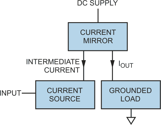

If the current or voltage input is referred to ground, level shifting must be used. Various circuits are possible, but the system shown in Figure 8 is suitable in many situations. This simple circuit uses a current source on ground to drive a current mirror on the dc supply, which drives the load. Note that the current mirror may have gain, so the signal current need not be as large as the load current.
Level-shifting current mirrors.
Figure 8. Level-shifting current mirrors.

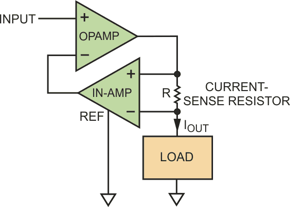

Today's high-performance instrumentation amplifiers (in-amps) are not expensive, so it is quite simple to make a bipolar current source using an op amp, an in-amp, and a current-sense resistor, as shown in Figure 10. Such circuits are simpler than the Howland pump, are not dependent on a resistor network (except the one integrated with the in-amp), and may have a voltage swing to within about 500 mV of each supply.

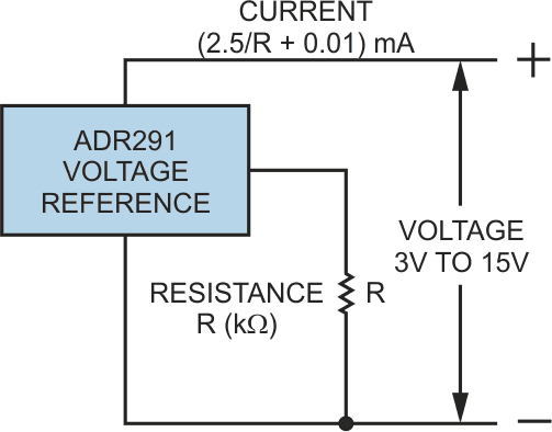

The circuits we have considered up to this point are amplifiers with precision current outputs. They may, of course, be used with a fixed input as accurate current sources, but it is possible to build simpler 2-terminal current sources. The ADR291 low-current voltage reference has about 10 μA standby current with a 20 nA/°C typical temperature coefficient. Adding a load resistance as shown in Figure 11, the reference current over a 3-V to 15-V supply range is (2.5/R + 0.01) mA, where R is the load resistance in kΩ.
2-terminal current source.
Figure 11. 2-terminal current source.

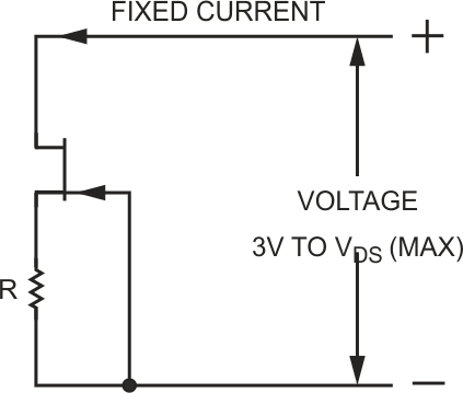

If precision is not an issue, and all that is required is a stiff unipolar current source, a current source can be built with a depletion- mode JFET and a resistor. This arrangement, shown in Figure 12, is not particularly temperature stable and, for a given value of R, the current can vary considerably from device to device, but it is simple and inexpensive.
JFET current source.
Figure 12. JFET current source.

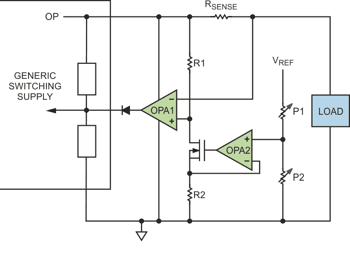

I recently needed power for some LEDs. Several engineer friends thought that I would have trouble making the variable current supply that is required for them to be dimmed. In fact, I quickly modified some "black-brick" laptop power supplies (bought for pennies at a car boot sale) to do the job. Figure 13 shows a simple modification that supplies constant current to the LEDs. With small output currents, it operates normally with a fixed-output voltage.
Black-brick switching supply modified for current-limit output.
Figure 13. Black-brick switching supply modified for current-limit output.
To make a variable current, a voltage reference – from the black brick or local – is applied to a potentiometer represented by P1 and P2. OPA2 and the MOSFET send a small current through R1, causing a voltage drop across it. The load current flows in the sense resistor. If the voltage drop in the sense resistor due to the load current exceeds the drop across R1, the output of OPA1 will rise, overriding the voltage control in the brick, and limiting its output voltage to prevent the output current from exceeding the limit.
