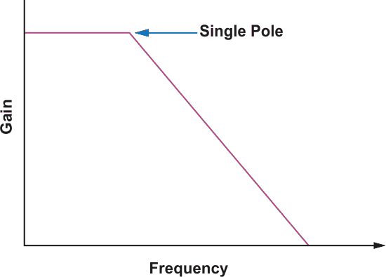

Another key advantage is simplified control loop compensation. The Bode plot of a voltage-mode regulator shows a double pole; a current-mode regulator generates just one simple pole of the power stage at this point. This produces a phase shift of 90°, instead of 180° with a double pole. Thus, a current-mode regulator can be much more easily compensated and thus stabilized. Figure 2 shows the simple transfer function of the power stage of a typical current-mode regulator.
A simplified control loop compensation through current-mode control shown in a Bode plot with just one simple pole in the power stage.
Figure 2. A simplified control loop compensation through current-mode control shown
