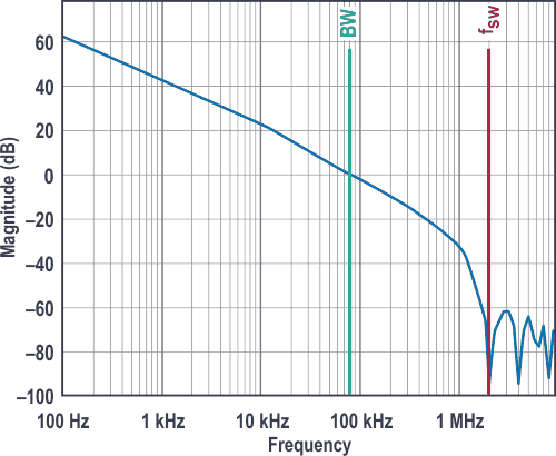

Figure 2 shows the gain curve for the control loop in a Bode plot. It yields two important pieces of information. The frequency at which the gain is equal to 1 – that is, at 0 dB – can be read. For the control loop in Figure 2, this so-called crossover frequency occurs at approximately 80 kHz. As a rule of thumb, this frequency should be no more than one-tenth of the set switching frequency, fSW, of the switch-mode power supply. Unstable behavior can result if this rule is violated. The second main piece of information shown is the area under the gain curve – that is, the integral of the function. The higher the DC gain and the crossover frequency, the better the control loop can maintain the output voltage at a constant level.
A Bode plot showing the gain of the control loop with a 0 dB crossover point at approximately 80 kHz.
Figure 2. A Bode plot showing the gain of the control loop with a 0 dB

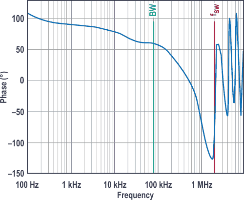

Figure 3 shows the phase curve in a Bode plot. The most important value that can be read from this plot is the phase margin. This is a value that provides an indication of the stability of the control loop. The phase margin can be read at the crossover frequency obtained from the gain plot (see Figure 2). In the example shown, the crossover point lies at 80 kHz. Therefore, the phase margin in Figure 3 is approximately 60°. Phase margins of less than approximately 40° are considered unstable. The control loop is optimally set when the phase margin is between 40° and 70°. There is a good compromise between fast regulation and good stability in this range. Above a phase margin of 70°, systems tend to be very stable but with extremely slow regulation.
The phase curve for the control loop with a phase margin of 60°.
Figure 3. The phase curve for the control loop with a phase margin of 60°.
