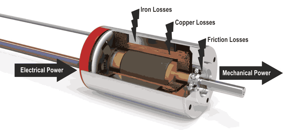

Brushless DC (BLDC) motors transform electrical power into mechanical power. However, there’s no such thing as a perfect motor; there are always losses in the transformation. The three main types of losses created during the conversion are friction losses, copper losses and iron losses (Figure 1).
| Figure 1. | This cutaway of a Portescap BLDC motor shows where various losses arise and the pathway from electrical to mechanical power. |
Friction losses are caused by the ball and bush bearings, and they are function of the application’s use (speed, load and acceleration) and environment (temperature, dirt and other factors), plus the bearing’s intrinsic characteristics such as material, wear, lubricants and sealing.

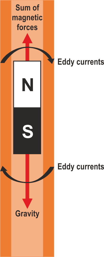

A small experiment illustrated in Figure 2 can explain this phenomenon. When a magnet is thrown into a slightly ferromagnetic tube – like copper or aluminum – the speed of the falling magnet is much lower than what would be expected.
| Figure 2. | This image illustrates Lenz’s law as demonstrated by a magnet falling into a copper tube. |
Why does this happen?
Lenz’s Law states that induced EMF is:
Δɸ is the rate of change in magnetic flux and Δt is the corresponding change in time.
According to Lenz’s law, when the magnet falls through the tube, the changing magnetic field induces current that flows in a direction that opposes the change in the magnetic field that produced it, thereby reducing the magnet’s speed.

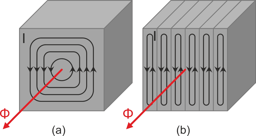

An effective way to reduce the impact of the material’s thickness is by laminating the core material (as shown in Figure 3). This creates a shorter path for the current to travel through, thereby splitting it into several small currents. Because losses are created with the squared value of the current, this approach is highly effective. So, to avoid current flowing between two laminations, insulate the laminations from each other with a coating.
| Figure 3. | Current circulating in solid core due to magnetic flux variation (a). Laminated core reduces drastically eddy currents (b). |

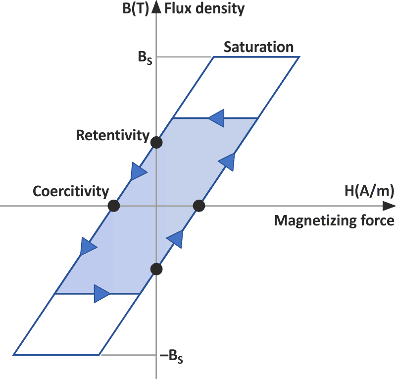

Hysteresis. When the magnetic flux is reversed into a ferromagnetic material, energy is lost as the material magnetizes and demagnetizes. To remove the remaining flux density, an opposite magnetic flux should pass the point of coercivity (Figure 4).
| Figure 4. | Hysteresis loop – the path of magnetization and demagnetization. |
These losses depend primarily on the magnetic induction in the circuit, but also on material properties such as permeability, volume and the flux variation’s frequency. That’s why it is important to select the right material for the right speed.
The Steinmetz equation can be used to calculate hysteresis losses and understand the influence of each parameter. It states:
Hysteresis losses = k × V × f × B × n.
Where k is a constant of the material; V is the volume of the magnetic circuit (m3); f is the magnetic field’s frequency; B is the maximum induction in the magnetic circuit (T) and n is a coefficient (between 1.6 and 2) that depends on the material

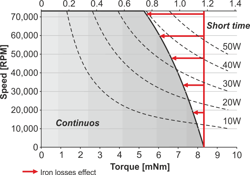

An BLDC motor’s various limit its maximum power, since it would burn if it exceeded a specific temperature depending on the motor design. This makes it critical to select the right motor based on the specific torque-speed working point.
Copper losses are mainly created when the motor is generating torque, and iron losses usually occur at high speeds. Consequently, the Figure 5 shows that for a given motor, the maximum possible continuous torque decreases when speed increases.
| Figure 5. | This graph shows the effect of iron losses on the power curve of a BLDC motor, the Portescap 16ECS36. |

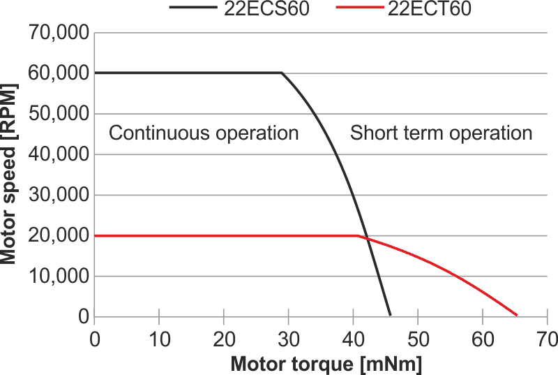

Changing the number of poles of a magnet can have a major influence on motor performance. Typically, long motors have two-pole magnets and can run at high speeds. Although this can increase the motor’s maximum torque, it also increases iron losses and thus reduces the maximum continuous speed.
Iron losses depend highly on the frequency of variation of magnetic flux for a similar speed, so increasing the number of poles increases the number of variations for one motor turn. For eddy current losses, this happens with the square of the increased frequency and can quickly reduce a motor’s efficiency (Figure 6).
