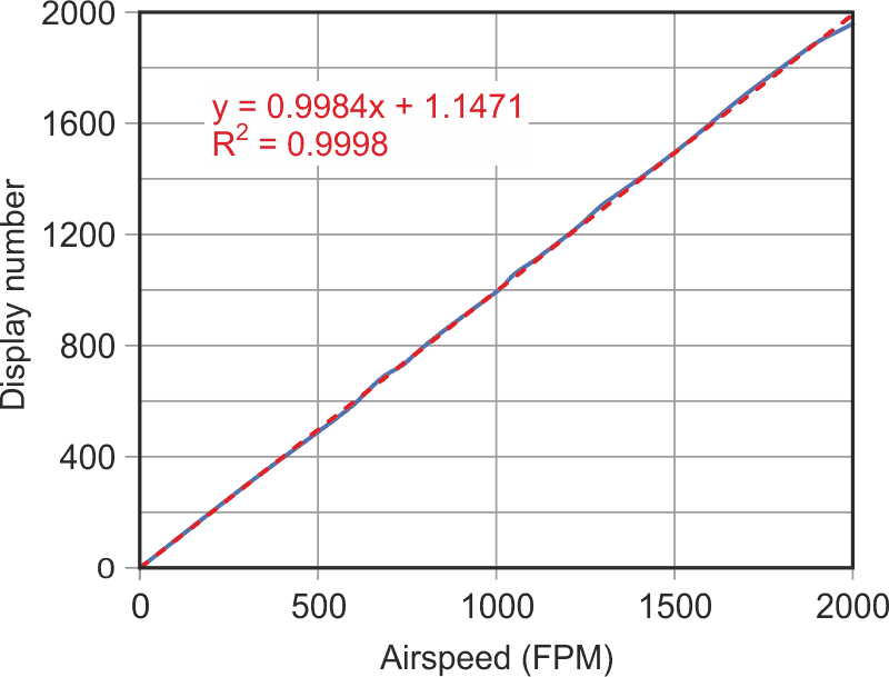

The calculation approach provides a highly linear, 1:1 relation between the displayed number and the airflow rate.
Figure 1. The calculation approach provides a highly linear, 1:1 relation

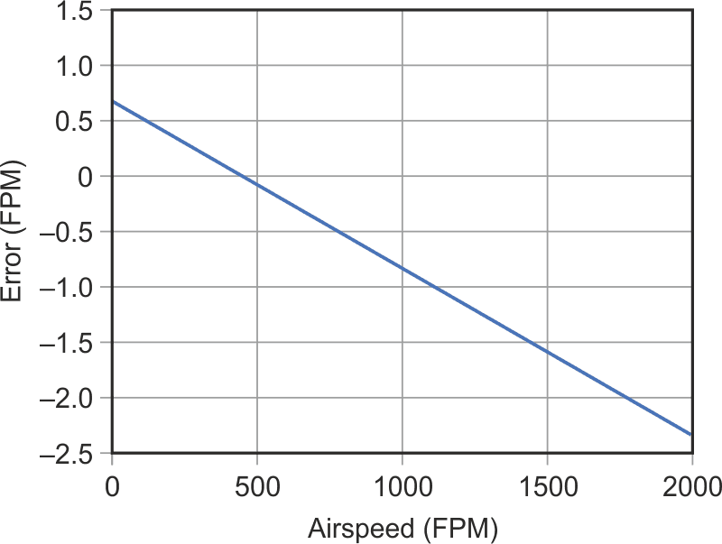

As Figure 1 shows, passing the sensor voltage through this function provides a highly linear relation between the number N to be displayed and the flow rate. Figure 2 presents the deviation between the discrete points of the response and the best fit linear equation. The error is within the ±2.5 fpm range, which is 0.125% of the maximum flow rate. This is 80 times better than the hardware solutions in the reference paper. An important feature is that the error will affect only the last digit in the displayed number.
Close insight reveals a very small nonlinearity of the overall response.
Figure 2. Close insight reveals a very small nonlinearity of the overall
response.
