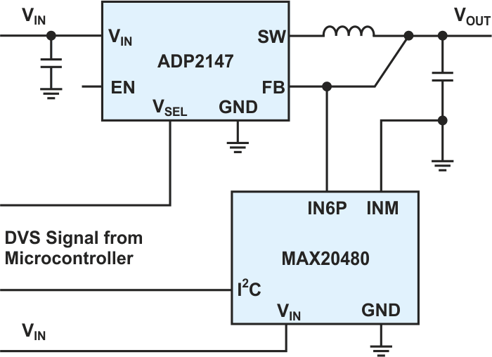

In some cases, an application that needs a tightly regulated voltage may require a monitoring IC for checking whether the generated voltage actually lies within the tolerance band. When there are no load transients, a simple supervisory chip is sufficient for checking the DC voltage, which normally lies within a much narrower range. However, this does not work with DVS systems because the DC voltage has two different values: the somewhat higher value and the somewhat lower value of the DVS concept.
Special monitoring ICs such as the MAX20480 power system monitor can also be used with DVS systems for reliable voltage monitoring. The MAX20480 has a digital I2C interface and, just like the switching regulator in Figure 2, it can be dynamically switched via the VSEL pin to monitor a higher or lower DC voltage when DVS systems are used. Figure 3 shows a block diagram of the DVS switching regulator from Figure 2 with an added DVS-capable voltage monitoring IC.
| Figure 3. | Monitoring with a DVS-capable supervisory controller for highly critical applications. |
